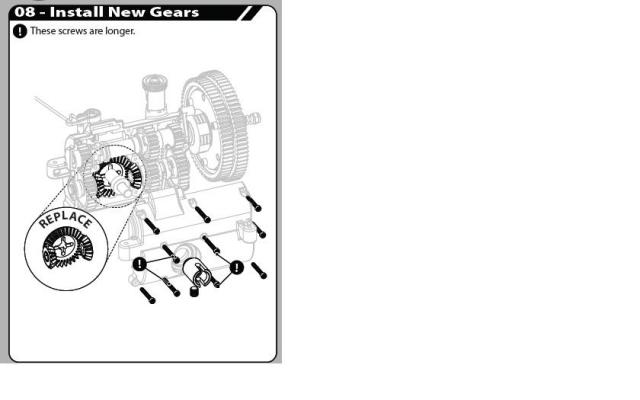

I looked through the assembly instructions and noticed something that I may have been unaware of - does the LST tranny also have a built in center diff?
Every LST based monster i ever seen had none, but wouldn't be too hard to make one

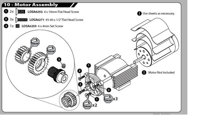

The first picture is what is making me think that there is a possibility that the motor mount might be able to accomodate larger motors - see the shims they show.
And the second one is why i asked about it possibly having a center diff - but that's probably how they change the drive direction.
I sent an email to Losi Customer support asking about the motor dia allowance. Will post as soon as I hear back.

HA...got my FIRST response from Losi today - stated that the size was 40mm x 80mm. Hmmm.....that just happens to be the same as the size of the "tape" shims that they include with the package. I sent a response back asking them to please forward the question to their engineering dept...
Yeah, its not a great set up. Doable, but not great.

Finally got an answer on the heatsink diameter.
Hi Jeff,
I'm sorry for the delay. The parts are not available to us yet to measure, so I had to contact Losi directly to get them to pull one for me.
The inner diameter of the heatsink is 42mm.
I hope this answers your question!
Looks like most Neu's will fit....
