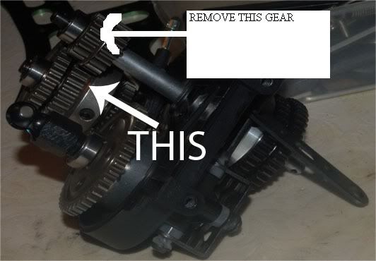

You just remove the second gear,and LOCK the centrifugal clutch in the engaged position.and then your done.I still see premature tranny destruction even being metal under a 1717,then after your tranny goes bye bye,I'd contact mike and see what he has to say or try a savage style center diff setup.--Josh

I'm going to run it with a 1527/1y 1250kv Neu motor. And btw, I can't remove any of the gears in the tranny. Atleast not the 2nd gear, it's attached to the centrifugal clutch house by bearing (The things I pointed at in the pic.)

Ok, thank you very much. I only need to tighten the screws in the centrifugal clutch to make it spin with the shaft, but I can't remove the first gear on the same shaft -- it's attached by bearing to the 2nd gear or something like that.
I will try to get an Emaxx input shaft, that does sound like the best option for slipper.

The 1st gear you refer to is attached to a one way bearing. You should be able to slide that gear off after you remove the 2nd gear and clutch. If you allow those 4 gears to mesh after you lock the 2nd gear clutch they will not turn.
If you cannot remove the 1st gear, do not worry, just do not instal the smaller gear that drives it when you replace the input shaft for the emaxx shaft.

Both the 2 gear on the input shaft and 2 gear on the middle shaft are locked together. The gears on the input shaft are 1 solid unit. :S

The 2 gears on the input shaft are likely one solid piece. The other two gears have to be seperate, as they rotate at different speeds. The non clutch gear is supported by a one way bearing, and the clutch hold the other gear in place. They will be removable, somehow.

They are seperate, but the first gear (On the middle shaft.) is attached to the centrifugal clutch by a one way bearing. The 2nd gear is a part of the centrifugal clutch housing - The one I pointed to in the pic you posted.

You should be able to remove the 1st gear by seperating it from the one way bearing.
