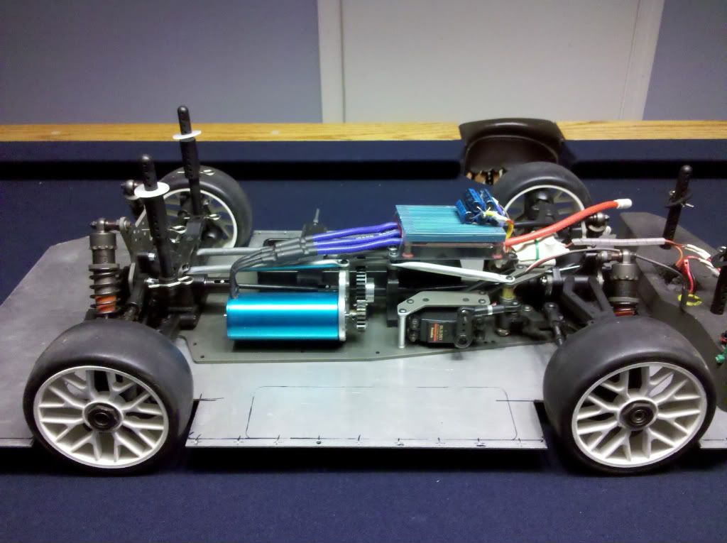

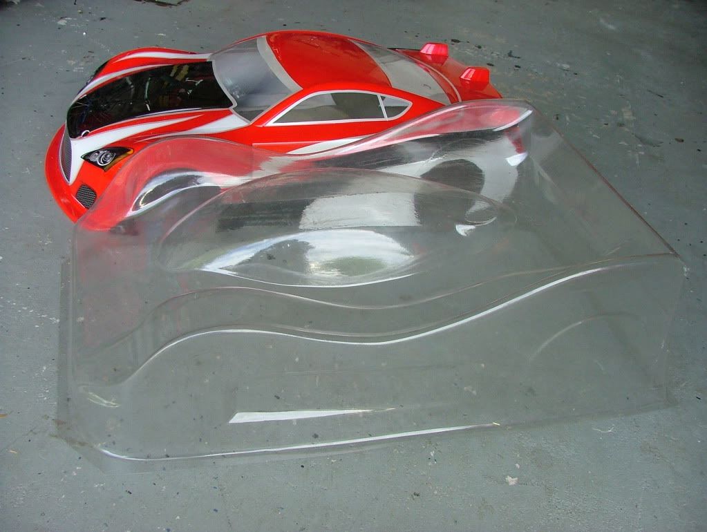

I run the protoform GT or Kyosho Ferrari body. I just got a Lola looking body from
TC5racer as well.

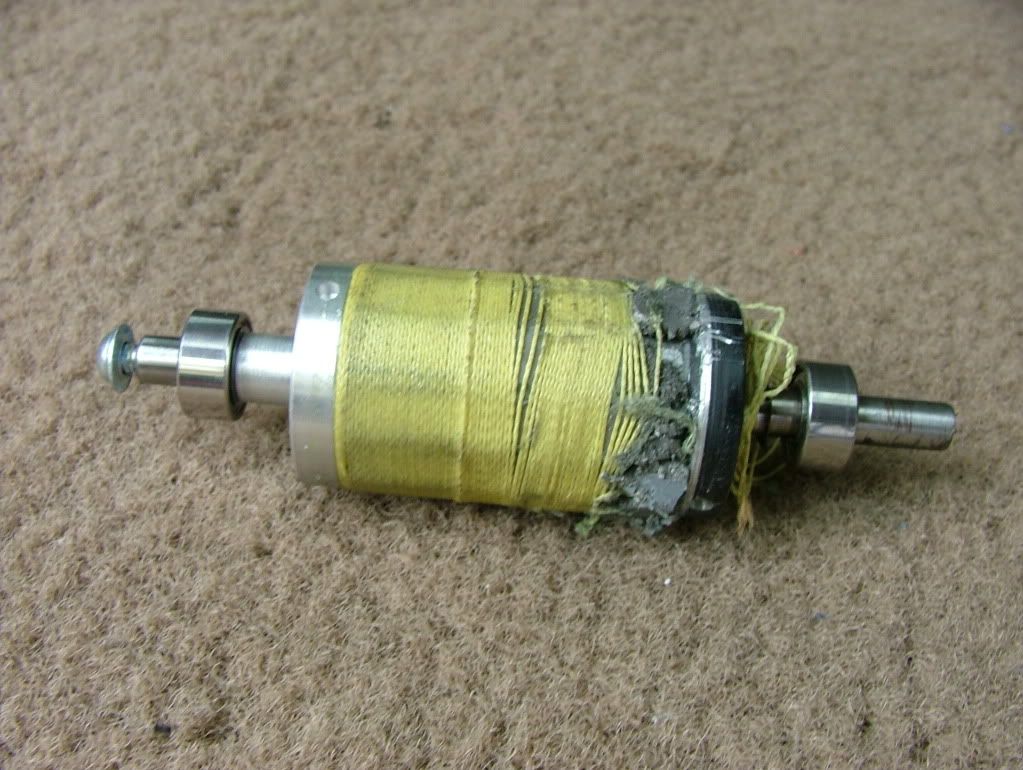

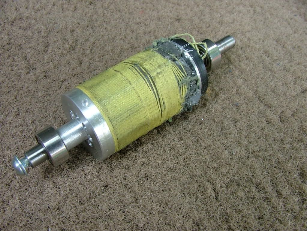

Well out running today and motor locked up. This happend running on blacktop and drifting here and there. I really loved the motor and the KV and torque was perfect. I slapped the longer 2300kv Bigmaxx instead and hope it last longer. Geared for around 54mph. It has too much torque for the poor blue foams.

Man that painted body looks sweet!!!
I'm sorry to hear about the Pletty sounds like I know what to tell the wife to get you for Christmas.

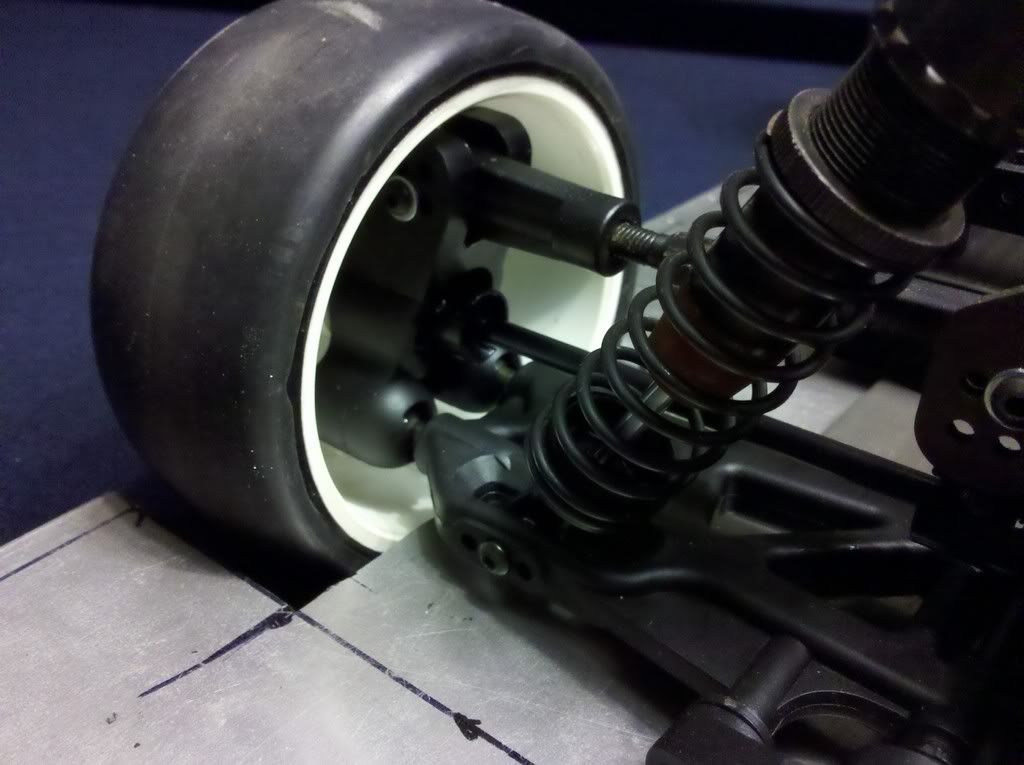

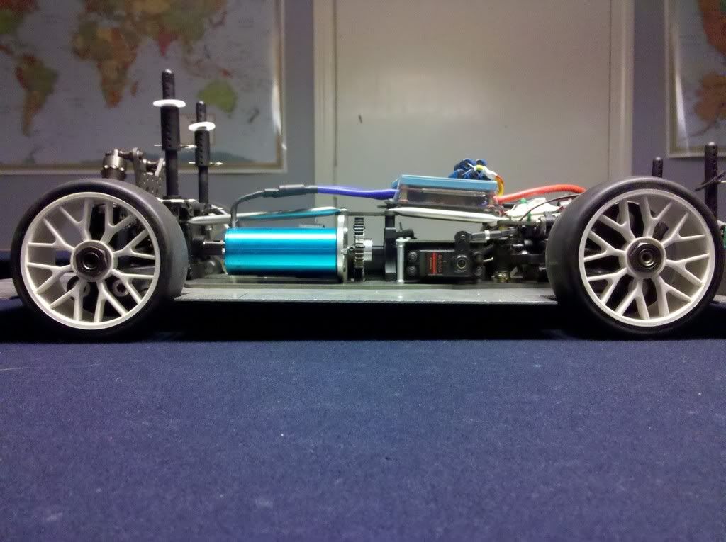

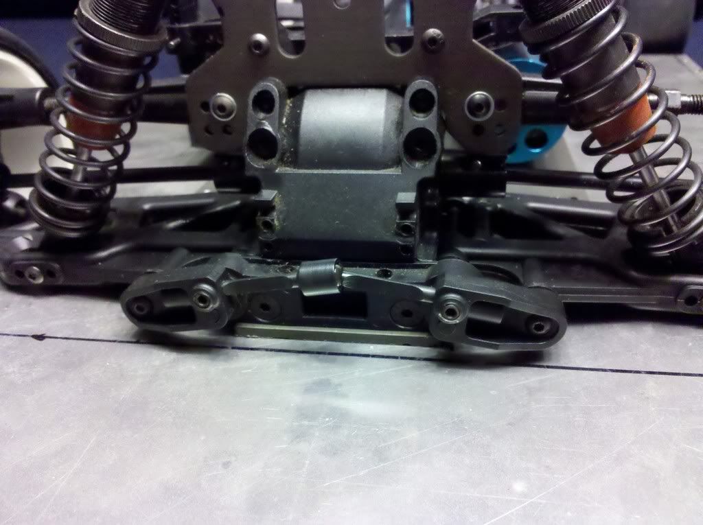

I wanted the pillow ball setup in the rear, but didn't want to spend an arm and a leg for it. So Ebay to the resque and bought OFNA Rear Pivot Ball Kit, MP-6 Part# 31297 for 14 bucks plus shipping. I had to shimmy it a bit, but now I have a nice 13" wheelbase. The thing is on rails and zooms like mad.
Here's the bigger motor. It's scary to drive with this beast.

Those shims should work alright. If you want the kit made specifically for the GTP, go HERE. That is the same one I bought a while back. Perfect fit! It also includes the newer style anti-roll bar and a spare set of front lower arms...
I can take pics for you after work tomorrow (today? ) if you want.....

The wheelbase as I have it set up is 12.8125". The kit I bought has spacers like you used in yours. When set all the way out the WB is 13".
The anti-roll bar setup is pretty slick. It's a ball-in-socket arrangement with adjustable tension. Very low profile, too.
The pivot ball carriers are the same. The lower arms are made specifically for the kit.
