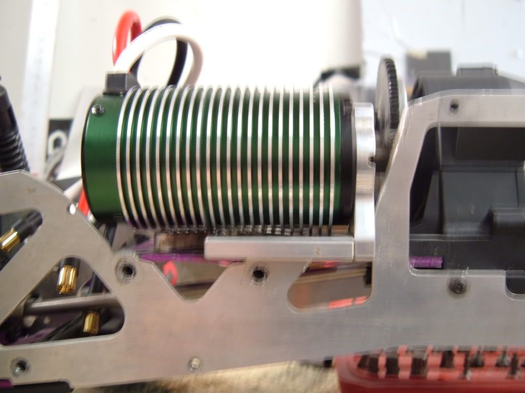

So I plan to use the 1717 motor. Got it to fit perfectly on an old flm electric motor mount, the one designed to bolt to a nitro savage motor plate. Thats right, no cutting or anything, bolts right on and just touches the bottom of the bracket, no flex!!! I do not see this part on flm anymore, but I will take pics for you guys!

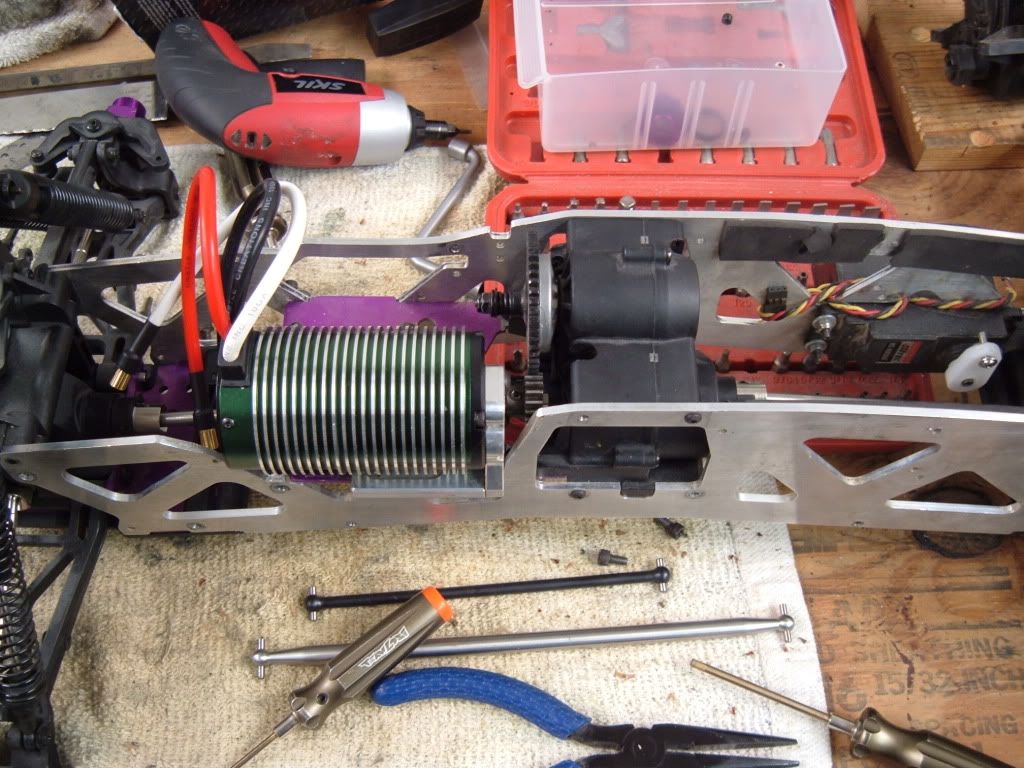

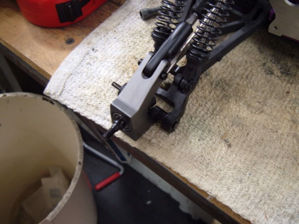

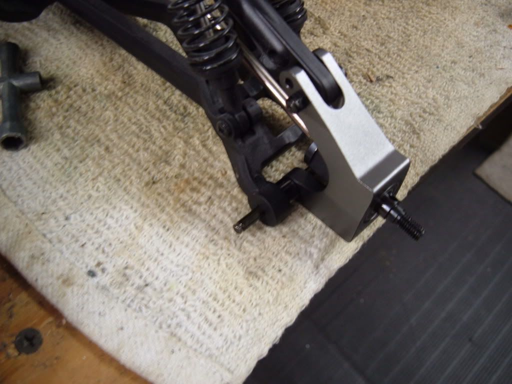

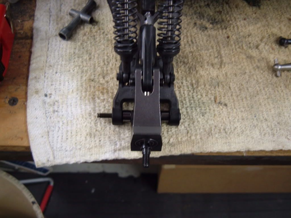

Here are some pics, enjoy.
You can see how the atomic hubs fit, need a few shims to get the slack out. Bearings fit well so i guess I cannot complain.

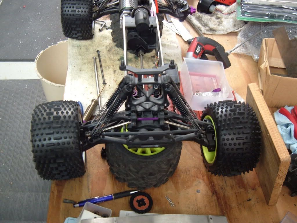

This chassis, which is not the savage 5t chassis as I found out yesterday even though the guy who sold it to me said it was...
Wheelbase here is 19", so the redcat rampage 5th scale body should fit it just fine. I will have to order one and see how the width looks, may have to go with the XL axles to get the width to look right.
The hubs that vortex linked will eliminate the rear turnbuckles, and they look just like the atomic ones I have pictured above.

These eliminate the rear turnbuckles:
http://www3.towerhobbies.com/cgi-bin...?&I=LXWSY0&P=7
01.05.2011, 02:57 PM
Have those coming as well. Ordered them a few days ago.

01.06.2011, 11:41 AM
I checked the wheel driveshaft length on the lst2, not much more than 1/4" more in length so not worth the time.
Yes, I have seen people use the big cen genesis arms and driveshafts on the savage.

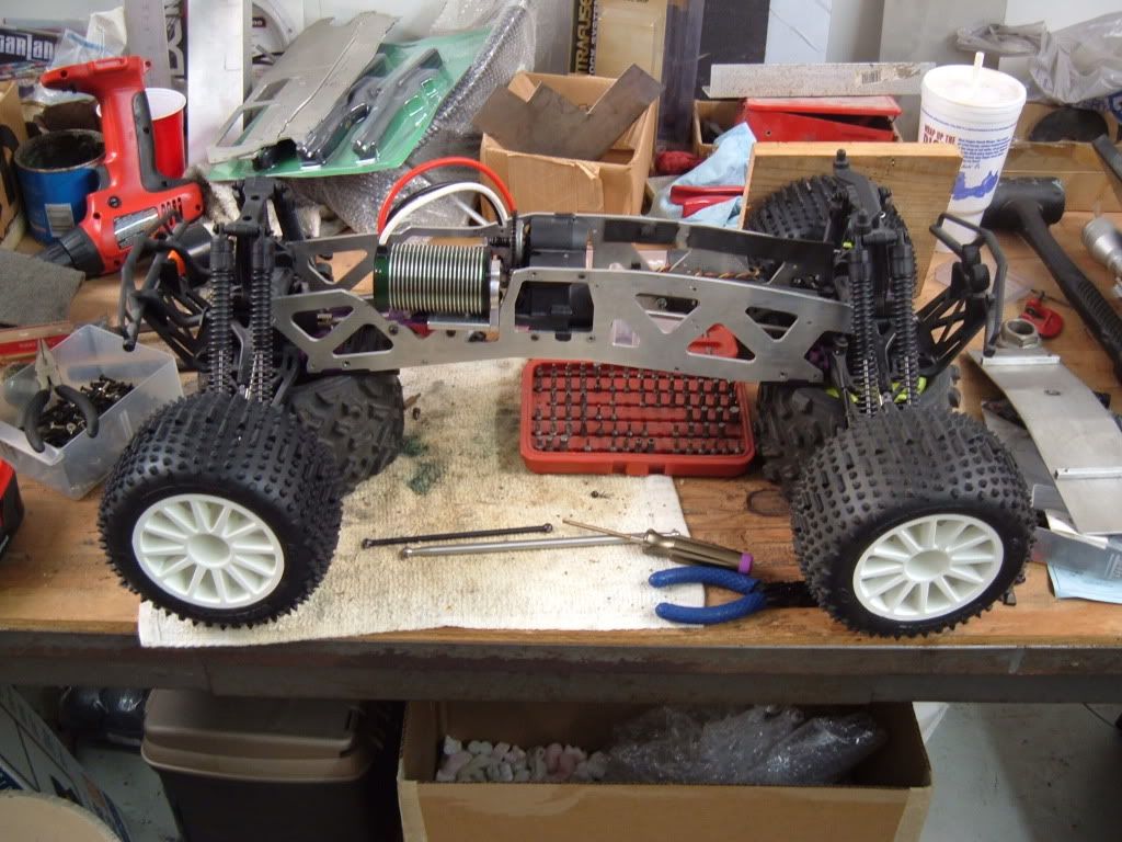

Here are a few pics with wheels on. I got measurements for the Redcat rampage body and it is 10.25" wide. So I think at 18" width now it will look a bit too narrow. Does anyone know how much wider the xl axles make the truck? Look at the pics it does not look like 1/2" per side, maybe less than that?

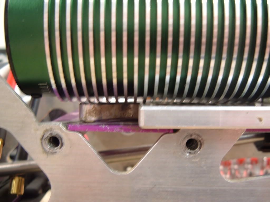

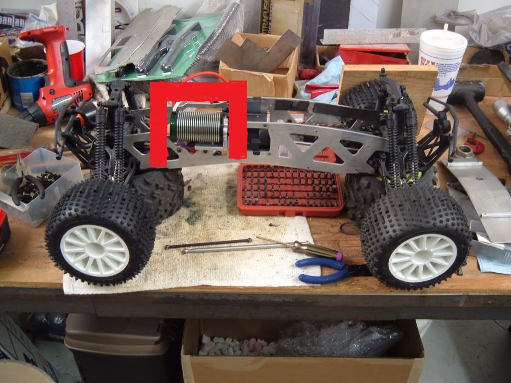

Just looking at my own pics, think the chassis could use a brace where the material was removed for motor clearance. Something like an upside down U that bolts in front and behind the motor and goes over the top of it.
Very poorly done pic, just to give an idea of what I am suggesting:
