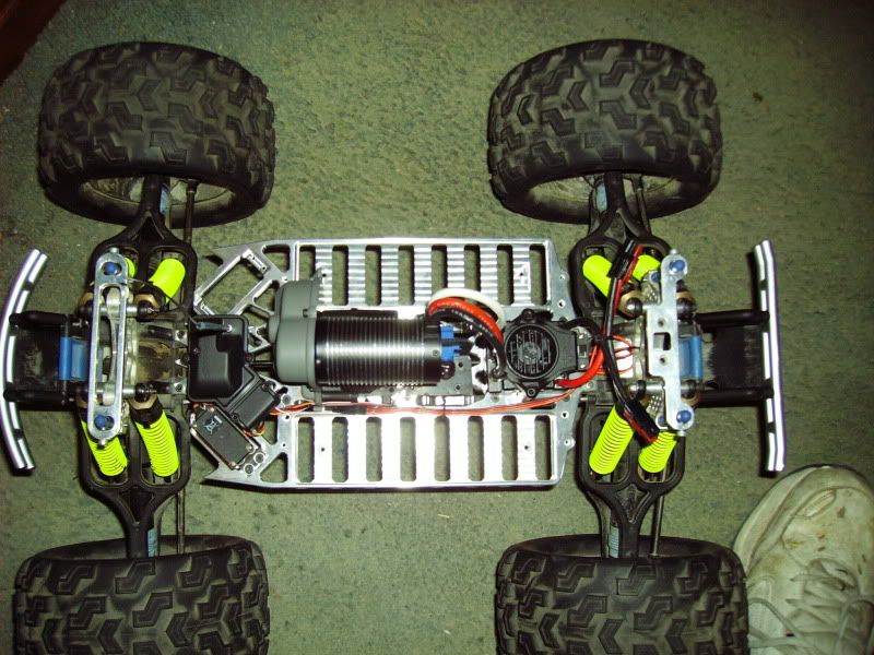

On a stock chassis the servo sits in a pocket molded into the chassis. FLM may habe a mount, otherwise you may have to make one. I've seen some people use a RC-Monster battery tray attached to the FLM chassis to secure their lipos better.
Are you going to try and keep the motor up front or turn the trans around so it's in the rear? Looks kinda tight for mounting up front, the servo can be swapped to the other side easy enough, but will the motor hit the bulkheads by the shock tower?

Well I was going trans flipped but will hit the esc and have to gring the chassis for spur gear.
It is to tight to the front so need to get another mount. Was looking at the one mike has in the store but not sure yet.
I have to see what I can come up with for servo mount.
Have to pick up the micro servo and linkage for it first.
Regular servo seems a little large to put in between trans and esc.

Overdriven
Destroyer of Tires
Overdriven's Avatar
Posts: 626
01.08.2012, 11:22 PM
Definitely go micro on the servo, no need for anything bigger plus they have only 2 mounting holes instead of 4 making things a little easier.
How much room do you need to mount the motor up front? Can you grind down the summit mount to move the motor back a bit? I was going to do that on my e-Revo to squeeze a 1520 in it without hitting the shock mount. Just make sure you can get the pinion on the motor and mesh right before you shave the mount down. Also if you mount the spur backwards it'll give you more room to shave the mount down more. I forget how much room you can get if you do all this, but it's something to look into. Would look neater with the motor up front than the esc, plus I like having as much weight up front in my Maxx trucks, seems to help on power steering and suits my driving style better.

I actually had the motor on there.
It fits but would need to move esc up front too.
It starts looking all jumbled in one area then.
I don't want to much weight in nose cause may roll over forward on brakes.
I think go with single motor mount and put over trans.

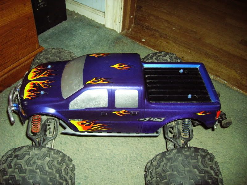

I found me a few flame stickers I had bought long ago.
I figure what the heck and added them to body to break it up a little.
What do you think?

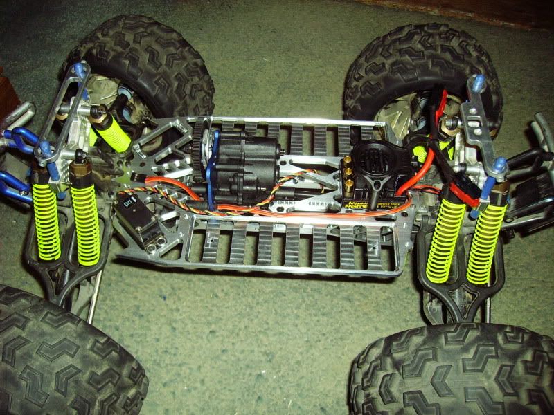

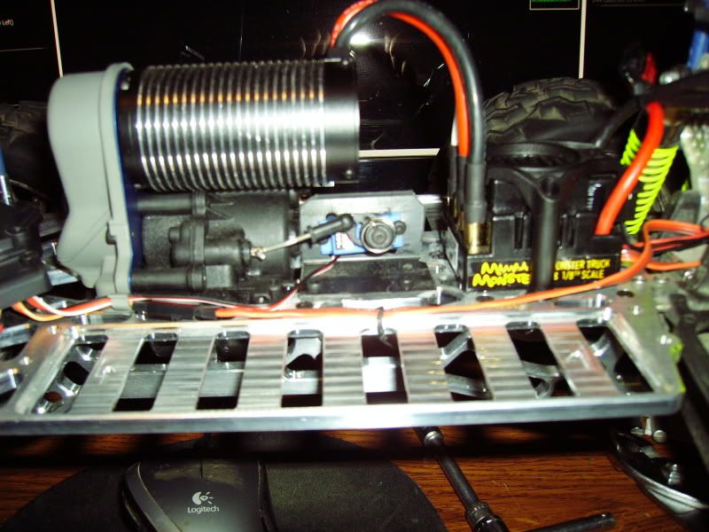

01.13.2012, 08:56 PM
Parts come in today.
I got the micro servo mounted up and functional.
Motor mount and box come in as well so got the receiver in box and wires ran.
I hope tomorrow may take out for a short test drive and see what happens.

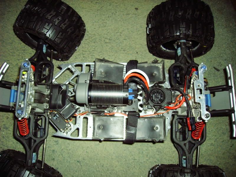

I got my parts and such in today.
Will try to get more photos later.
Mounted some battery holders on chassis.

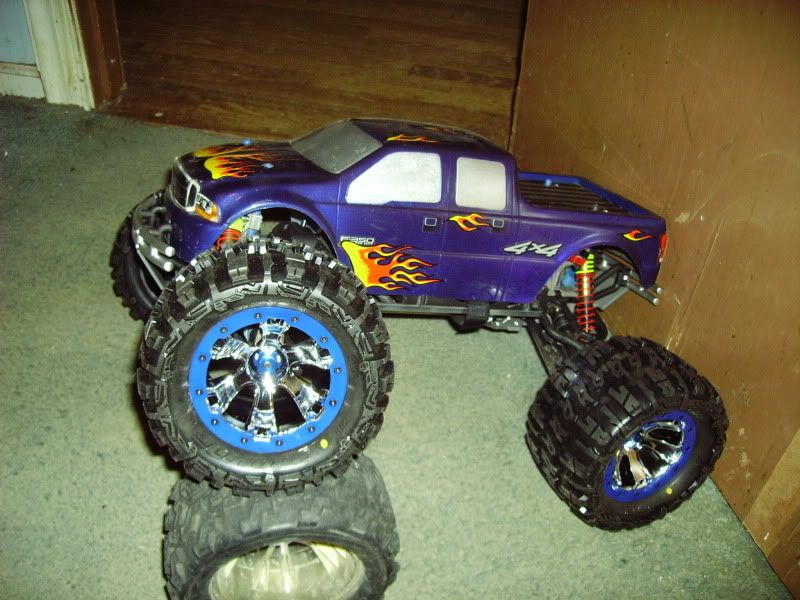

New tires are mounted up.
Proline Trenchers is what I went with.
They feel pretty light for there size.
Since I broke up some of the shocks on last run I went back to 4.
I did some spring modification on them.
maybe not prefect but works well it seems.
