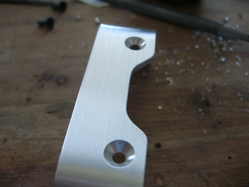

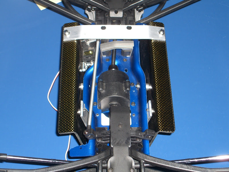

The lady is nearly finished;

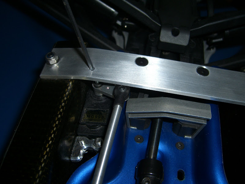

Here is the steering link from aluminum with hard steel M3 inserts;
One well placed hole to reach the servoscrew;
Using this ball-stud from Serpent on the servo, they are really handy, it has got a M3 thread till the middle and from there it fits a 3mm allen key..
  (#29)

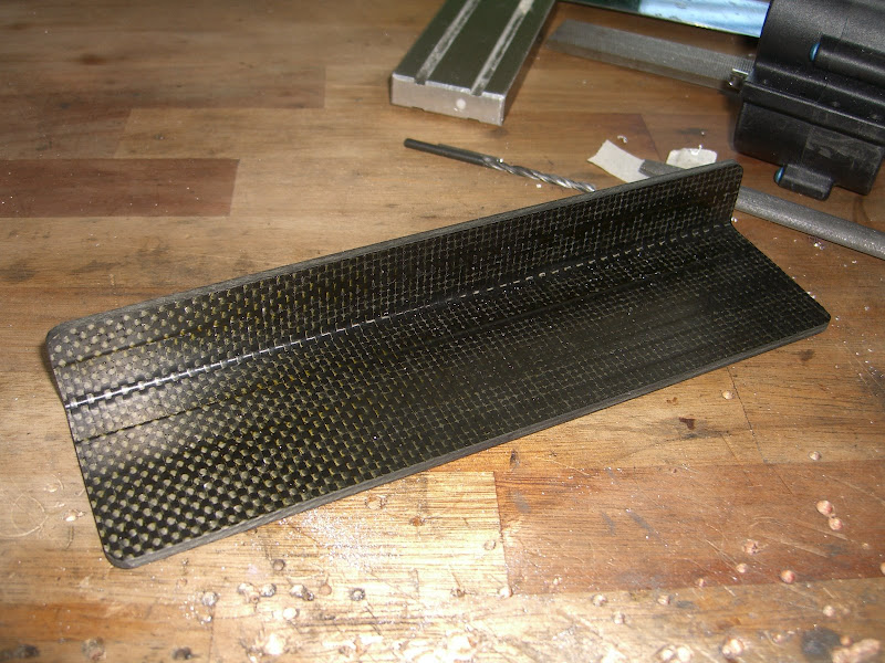

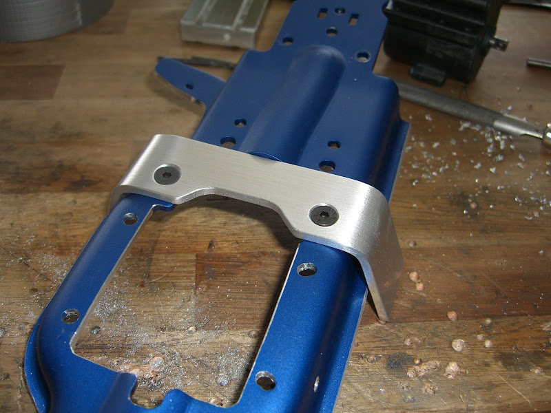

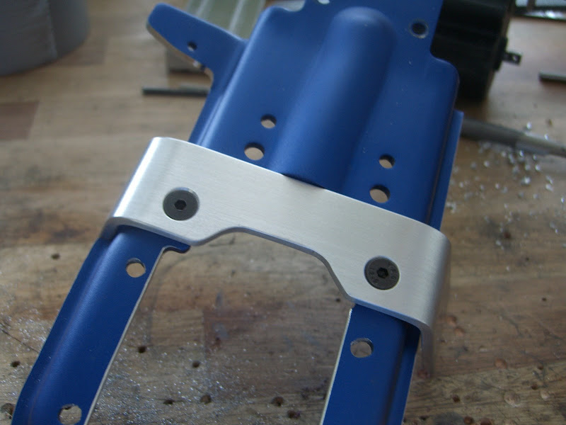

Serum, what are you using to bend that aluminum plate. Your bends look really clean.
  (#30)
Serum
Serum's Avatar
Posts: 10,480
05.06.2007, 01:54 PM
two wooden plates and a clamp.. (and some elbow grease)
