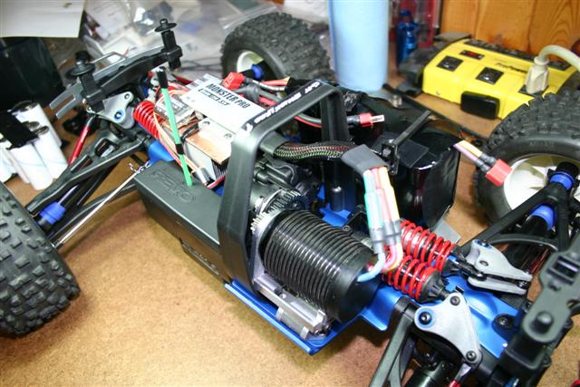

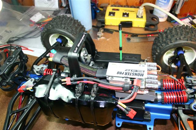

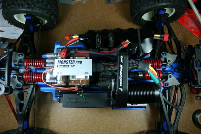

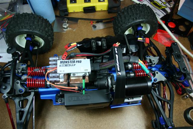

Hey guys, here are some pics of my Revo 3.3 conversion I am just finishing working on (wasn't much work). It's got a 1512 3D (1700kv.), Quark 125, 7s1p A123 pack (going to try it and see if it will handle, if not, will use 2p). I made a simple alum. plate of the one side of the chassis for the pack to be strapped to, hopefully it will stay on!
The truck will weight in at roughly 9 lbs. RTR. So it will be very light and agile... hopefully it will preform as good as it weights.
