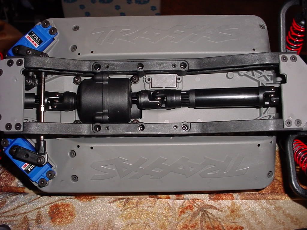

The new style Transmission mounts different. It mounts to the underside of the chassis instead of going through the frame rails. 4 Bolts is all it has compared to 8 mounting bolts with the old style.
If you want to upgrade an older maxx, get the Chassis and the frame rails to go with the transmission.

Got pics? I wonder if the width of the new mounting points is okay, and it just requires 4 new holes drilled onto the chassis (mount it ontop, rather than underslung).....

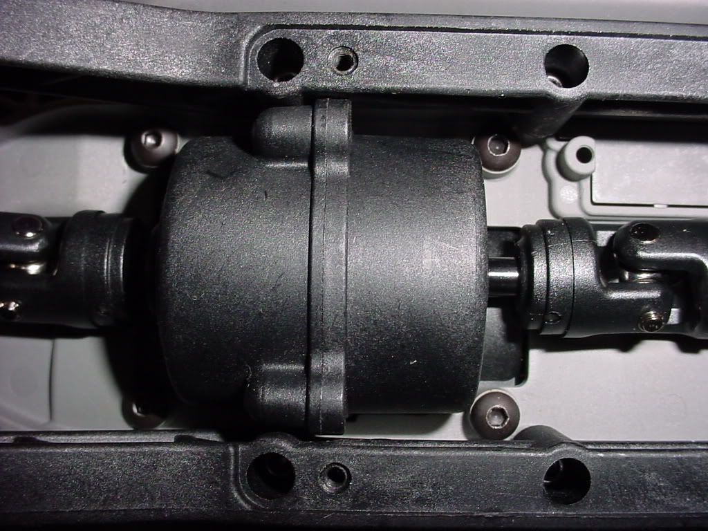

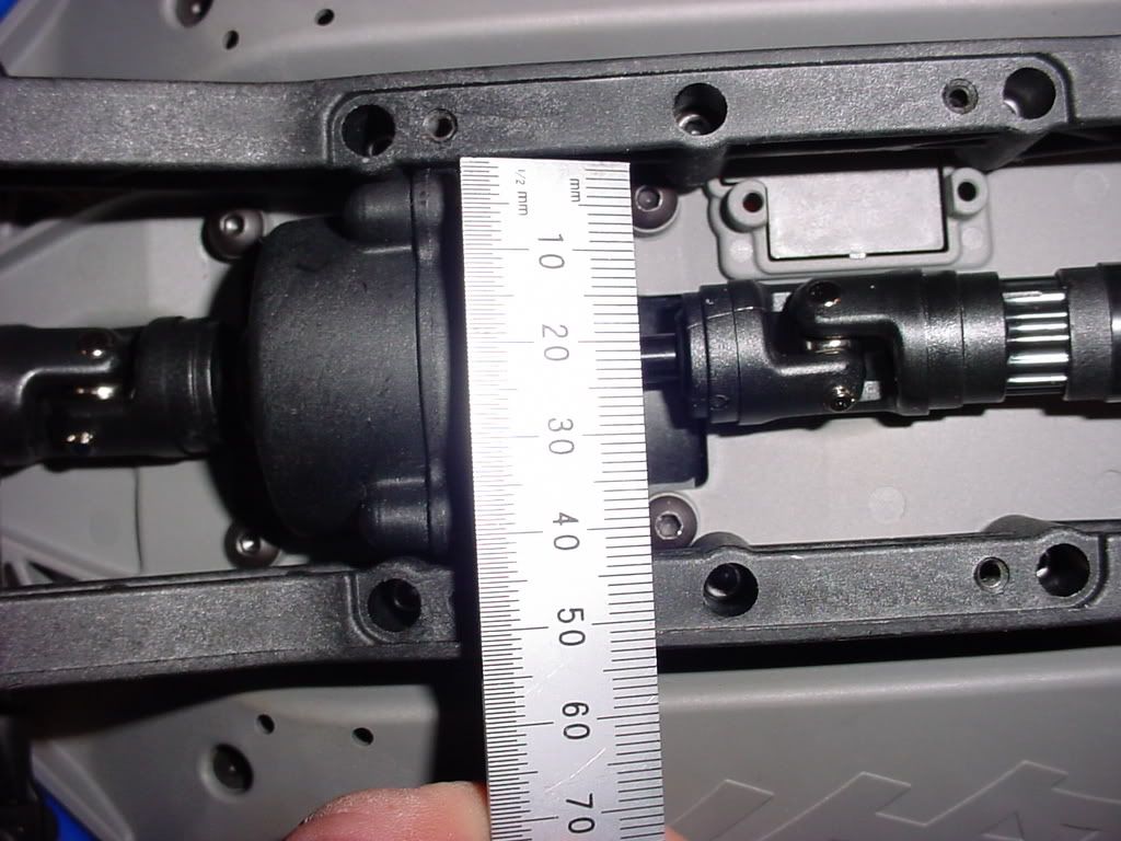

Ok Neil, here ya go partner.
Check out the pics. You can see the 4 tranny mount bolt there on the underside of the chassis. Bolts are 41mm x 52mm center to center.
