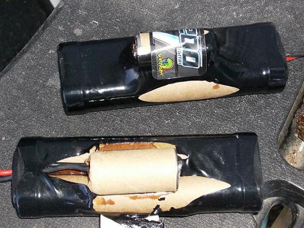

OK! Finally got things to work and run my revo again! GMaxx single speed tranny, revo slipper clutch, MGT Mod1 spur 49t, Novak prototype Mod1 5mm bore 13t pinion. This is giving me a 23.75:1 total reduction. Motor and esc where barely warm. First run was with Venom 4200Mah 7 cell packs, they're toast! shrink melted right off the hump cell and one was smoking! The packs only have 5-6 runs on them and this is a conservative gearing setup. Throwing caution aside I immedietly grabbed my 4500Mah all-battery.com packs and threw them in! Absolutely NO PROBLEMS!!! Way more punch, more speed, and the batteries didn't get any hotter than in my stock E-maxx. I don't wanna bash anyone but I haven't been happy with these Venom packs since day 1! I recomend all-battery to anyone bashing or even racing with Ni-Mh. These packs are less than $30 each and pack a ton of power! I love my new set up and will be ordering some 7 cell packs from all battery as soon as I can!

Whenever I hear 'Venom' and 'Nimh', I think 'toast'.... glad the other packs are good though, no sense spending massive amounts of money on Nimh packs for just general bashing.
Thanks Neil, always good to get ur input! Wish someone had warned me b4 buying them! Have thought about going LiPo but that's a big investment, 2 packs at $100+ and a charger at about the same then the worries of fire and explosion. $300 and I can only charge 1 pack at a time or I could buy 10 7 cell packs that I can charge on the chargers I already have....Looking at it like that it's a pretty easy decision!
