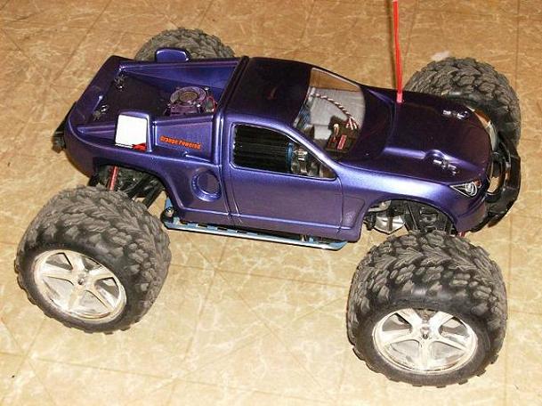

Here is a pic. I didn't do the body, bought a rolling chassis and it came with it, looked like crap with the tires the guy threw in but once I put some stock revo talons on it the Hummer body looks decent, just wishing for a better paint job. A spektrum DX3R is in the works as is a crowd pleaser 2.0 body

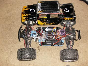

Added a Robinson Racing dual slipper and a crowd pleaser 2.0 body, kept the paint very simple with one color but I think it looks really sharp and the niro guys wont realize what just blew by them!
