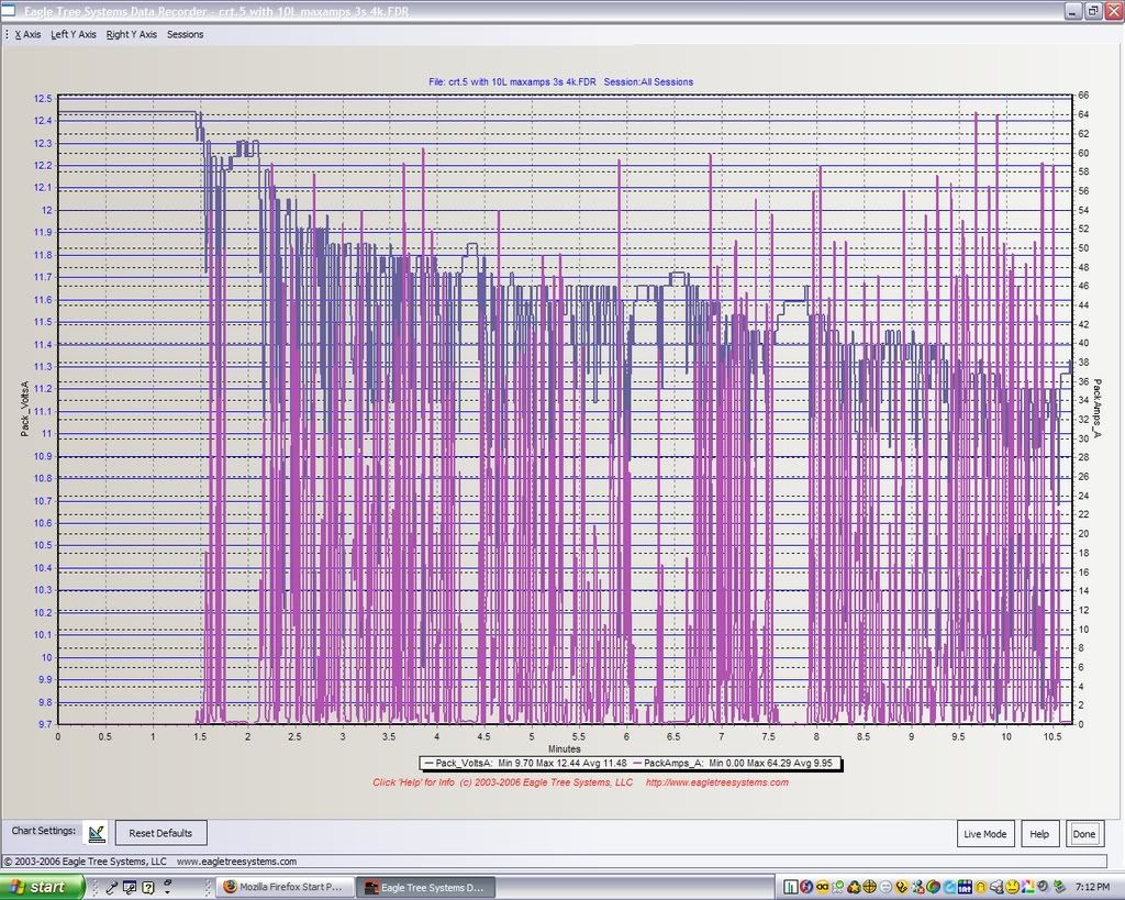

Brian, I ran the crt.5 again with the 10L and maxamps 3s 4000 pack. I hooked up the eagle tree to it and found some interesting numbers. Apparently the 4000's are not really 20c, more like 10-12c. Disappointing to say the least. What do you think, here is the graph. 64 amps and the pack voltage drops down to 9.7! I thought these were supposed to do 80 amps continuous, 120 amps sustained, and 200 amps burst...

Wow, that IS a pretty good size dip of 3.23v/cell. Was that dip towards the end of the pack? If so, it makes sense...

It was just before the 10min mark. I've gotten about 30min out of this pack so 1/3 of its pack life.

Very interesting I'm running the Maxamps 3s 4000 pack in my CRT.5 also and with the Mamba Max 5700 geared for speed runs the pack was getting warm around 120deg and I noticed it melted the shrinkwrap on the end a little? I just got a Eagle tree and need to figure out how to use it? I swaped motors and put a Neu 1506 5000kv in and the highest temps I have seen in the 4000 pack has been 105deg when I get the Eagle tree figured out I want to drop the 5700 back in and see what kind of amps it pulls compared to the Neu? :)
