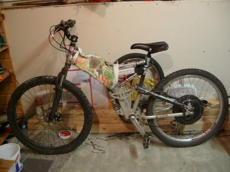

Here's a pic of my bike as it stands now (click for a direct link to the pic w/o photobucket crap)
I am running
9c (9x7) 26" rear hub motor
66.6v 10ah turnigy lipos
Ecrazyman 72v 45a controller
Hobbyking voltage/temperature monitor
Hyperion eos0610i charger
And on my list (recommended items)
Maxxis hookworm tires
More powerful power supply (8 hour charges suck)
Cycle Analyst
Controller usb hookup (mainly to change the amp limit)
-Also am considering making the motor delta/wye switchable
The Hobbyking VT monitor is great. It provides readings and an alarm for low voltage and high temperature, in this case my motor. I wrote a review (at a great ebike forum) - http://endless-sphere.com/forums/vie...17958&p=262221
I got my controller from this guy on ebay. His name is Keywin and he is very helpful/knowledgeable and is a pleasure to deal with. His prices are great too. You can send him a message and tell him what you need. Tell him your motor and your voltage for an ebike and he should be able to pick you out a great controller. Let him know what you want for a lvc; I excluded the lvc. I have the 72v/1500w controller. 12fet iirc. He has larger and smaller controllers.
You can email him at ecrazyman@gmail.com
Keep in mind there are many other places that sell controllers/kits.
minimum you will need motor, controller, throttle, and torque arm(s). About everyone would recommend running 2, especially if you're running 750+w.
