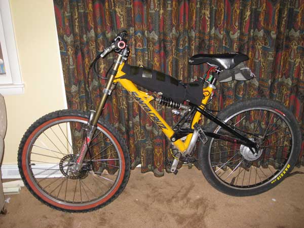

I got in some hub motors a few weeks back and laced up a wheel for myself. I ended up mounting it into my old downhill bike for grins and giggles, and so I would have cheap transportation around town. Works out to about a penny per 9 miles of travel at 20mph.
specs:
Rear geared brushless PM motor
Castle HV110 controller
12s2p a123
Magura throttle
Santa Cruz Bullit
Marzocchi Super T fork
Built up by me
Right now it is about 20mph on 36v. I have 12 more a123 cells so I can bump it up to 48v. Yesss, feel the power!! It already pulls wheelies....

Total cost of what? Electrics for the conversion are $800ish with the a123. Batteries are the bulk of the cost generally.
Originally Posted by t-maxxracer32 View Post
what is your average runtime?
about 12 miles best guess, I haven't ran it down all of the way. A trip to town and back (8 miles) is about half of the capacity. This is going 20mph. If I add voltage and go faster my watt/hour/mile goes down.

For cheaper electronics you can get by with $500 no batteries. For more expensive electronics $600 or more is easy to spend, and you can get lighter with RC electronics. Add batteries on top, and that will be an additional $120 to $200 for lead acid and $500 to $2000 for lithium depending on range and voltage that they want.
