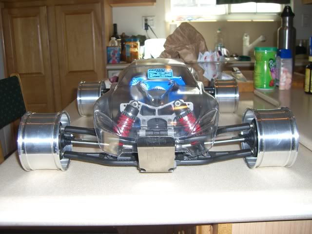

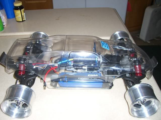

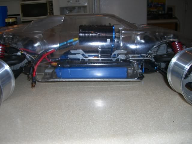

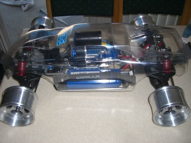

Its kinda hard to tell but the slipstream body Neil recommended is just about perfect!Thanks Neil. I was thinking of fastening it another way rather than cut holes in the body. Like some sort of velcro on the inside of the body but not sure with the paint on the inside of the body it would be able to hold at those speeds. Heres some pics:
Look how the body is lined up perfect with the bottom of the chassis.
This reminds me of John Forces top fuel funny car. This body is very sleek and aerodynamic it should work perfect. I am thinking about putting a foam bumper on the front and shave it down to act like a splitter. I could cut and bend the front titanium skid to be the front mount.

I wouldnt butcher the Ti skids too much, those things are so hard to get hold off & you'll regret it later down the line.
Velco pads is fine, use rear body posts in the front too as they have that cross brace; cut the actual stubs off then use velcro strips to stick the body shell to the cross braces- shouldnt be an issue with the paint coming off the body, not if you use an adhesion promoter and the proper flexible lexan plate.
The front skid itself could be an issue, seeing as it is angled in such a way as to direct air under the truck, therefore creating lift- needs a front wing I reckon, mounted off of the front bulks perhaps...
Too much fun to be had working all these things out, but thats half the fun....

I have about 5 sets of titanium skids so I am not worried about it too much. I think the skinny front skid causing lift wont be a problem because the wide front hood and windssheild should over come it with some good downforce. I am probably going to chop it and bend it down for the front bumper splitter I am thinking about making anyway . I am going to try it without a rear wing at first if that dont work I will put one on with very little or no downforce. The verticle up rights on the sides of the wing should help with high speed stability if there is an issue.
