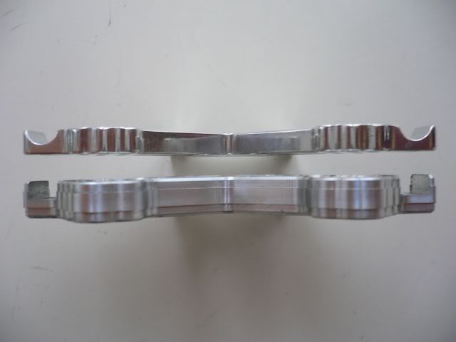

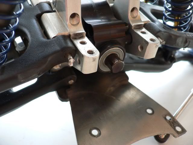

DAMNIT I just wrote a bunch of stuff about the lower FLM here then it deleted it all... Well here are some pics of what I made. Stock shock Blocks and 1/8 Shock installed too... Here is my ride...
http://i264.photobucket.com/albums/i...v/100_4086.jpg
http://i264.photobucket.com/albums/i...v/100_4073.jpg
http://i264.photobucket.com/albums/i...v/100_4072.jpg front needs extra dremeling because of steering rods and needs to go inside.
http://i264.photobucket.com/albums/i...v/100_4074.jpg Traxxas CVDs wont rub the Arms & RC8 Shocks work way better without mods but I made some blocks anyway for extra ground clearance.

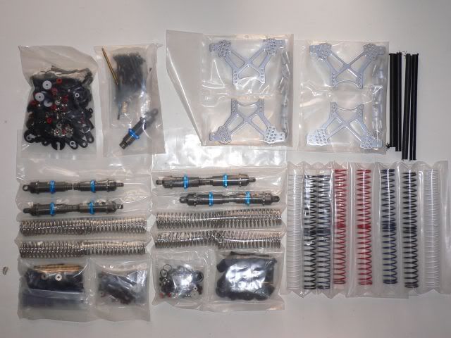

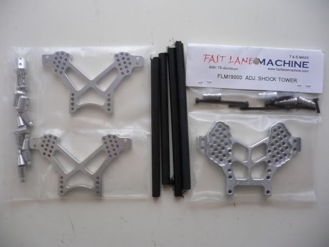

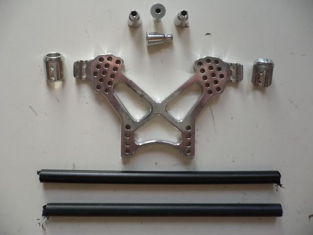

The last upgrades are finally here !!
UE shock towers, Supershocks and spare parts :
Plastixs ejector pins :

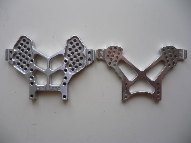

FLM vs UE shock towers :
Thinner, lighter (30g vs 50g), stronger (7075-T6 vs 6061-T6), UE shock towers are supposed to be better ! Body posts and shock standoffs are included :
The standoffs are perfect for the stock or Big Bore shocks but for the Supershocks you need the standoffs included with.... the Supershocks, logical...

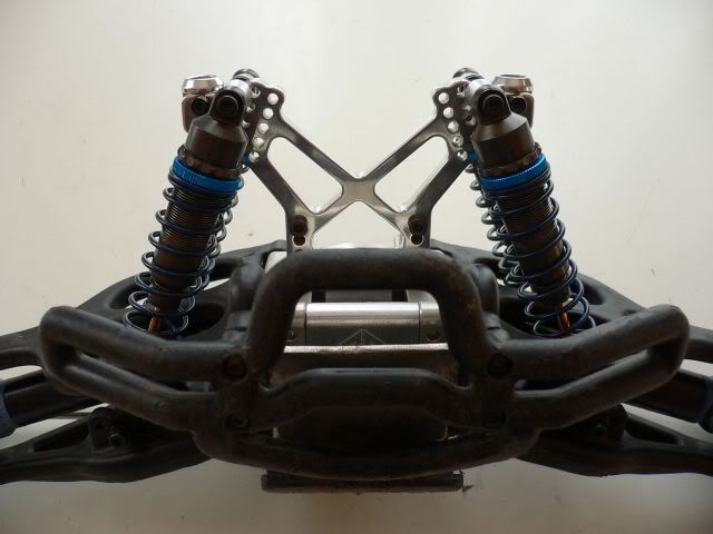

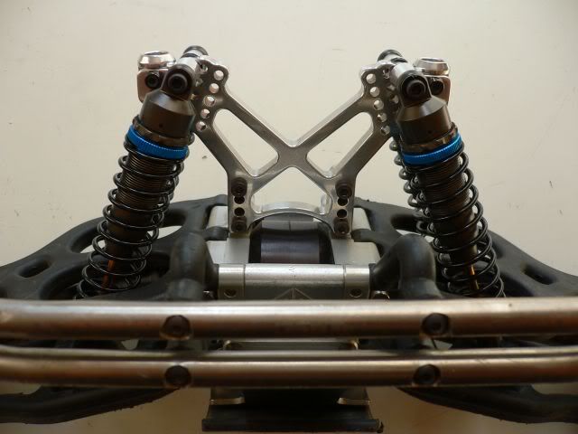

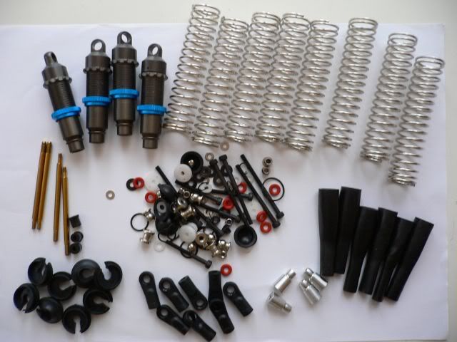

The Supershocks are easy to mount, spare parts are included to mount another shock, that's cool !

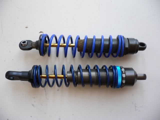

Before :
After :
vs. Big Bore :
I used 2 caster spacers between the tower and the standoffs, and some spacers included with the Supershocks at the bottom of the shocks to have them vertical :
And good news, the shocks don't rub against the stock driveshafts !

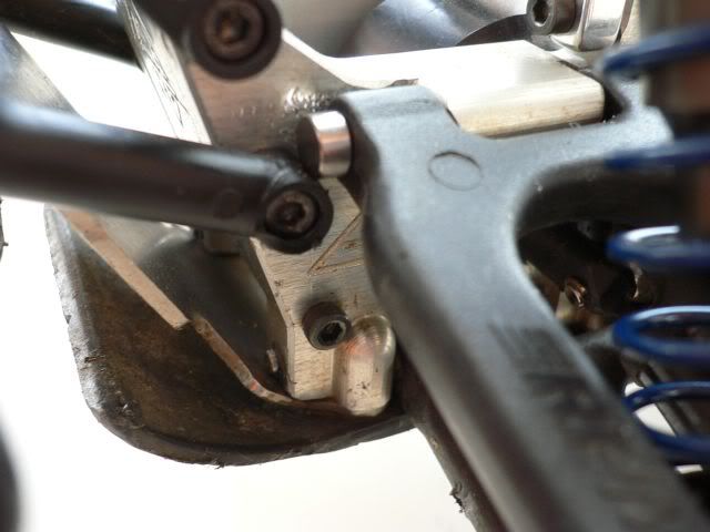

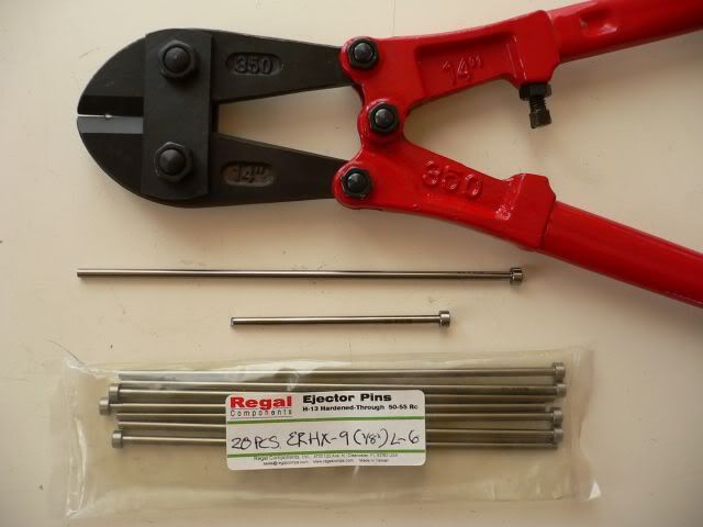

I wanted to test the ejector pins used by george16 because I'm fed up bending Lunsford hinge pins (lower ones). I needed a good bolt cutter to cut these pins ! Here is the result :
Given that my tools are really basic I can't do what george16 did so I wedged the pins thanks to their head and the bumper mounts. I can't do that with the front lower pins so I kept the Lunsford ones.

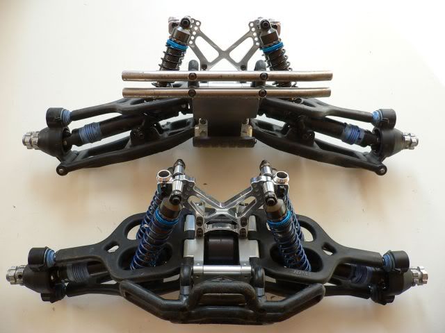

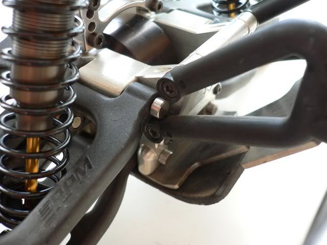

Some pics of the build :
I can't reassemble my maxx right now I need the bellcrank posts I broke during the last session. I will soon receive them with my ProTek 2s 50C lipo packs for my ERBE.
Last pics next weekend !
