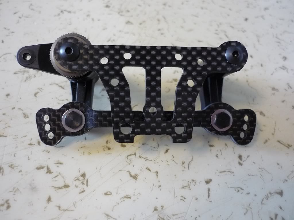

I was originally planning to run DM-1 shock towers in my Jammin conversion since they both use the same bulkhead, but then decided to use modified X2 towers. After kicking that around for awhile and also changing my shock choice (from 1/8 buggy fronts to Revo shocks) I finally found the perfect towers, which are from the IGT.

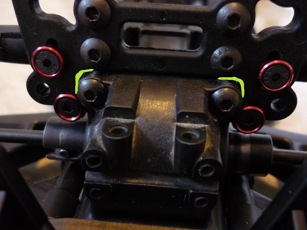

The IGT towers bolt right up to the Jammin bulkheads, since they are almost identical. There are only two small mods that had to be done. One was adding a tiny amount of clearance on both the front and rear towers, and was about 30 seconds of filing, VERY tiny amount of material removed (see pic 1, highlighted in yellow)
The second change was that the hingepin holes in the IGT front tower didn't line up quite right with the Jammin upper hingepin holder. I just decided to get rid of the front upper arms and hingepins altogether, and use a turnbuckle setup instead. Already had the parts in my spares bin. (see pic 2)
So now the towers are all set, and seem just about perfect for the Revo shocks with all mounting holes usable for plenty of adjustment. And the body mounts can be placed on the stock IGT tower locations rather than me guessing with the modded X2 towers, so I know the bodies will go on right. I'm going to run the plastic towers for now, but I'll definitely be saving up for a set of CF IGT towers.

I like how you built up those diffs with a bunch of different brand parts, sounds like they are bomb proof. Any issues at all with fitment, anything not lining up/clearance issues and needing machining?

The diffs all came together perfectly believe it or not, I call them Frankenstein diffs LOL! The only part I was unsure of was the Sportwerks TiNi ring gears, but they bolted up just fine. I had to shim them a bit inside the diff bulks, but you'd need to do that even with the stock diffs.

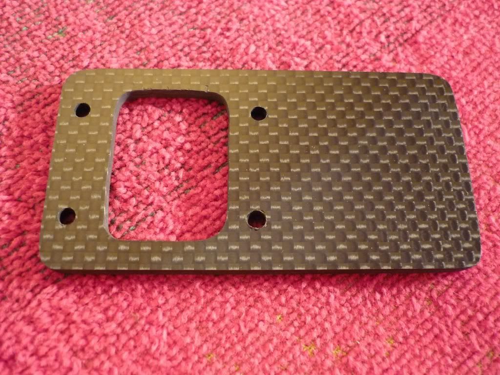

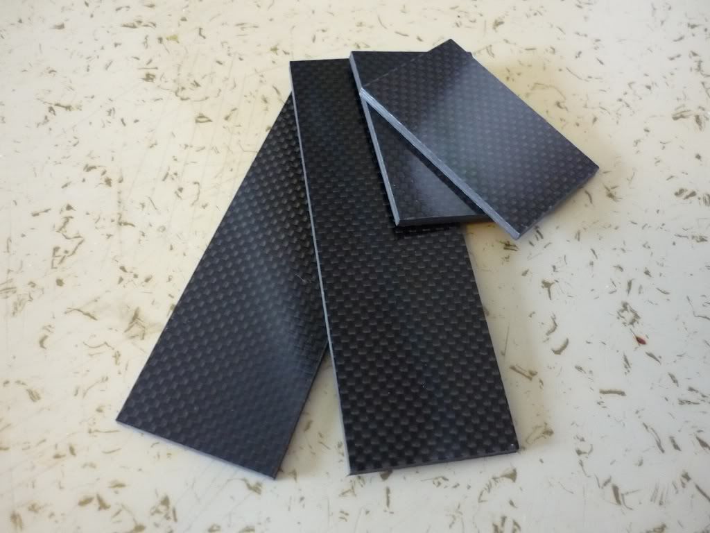

Got my CF ackerman plates in yesterday and mounted one up. Along with them I got a few small pieces of 3mm CF just to have on hand for any custom parts I might want to make. Mainly I am going to make a center diff top plate that extends out as a rack to mount the ESC.

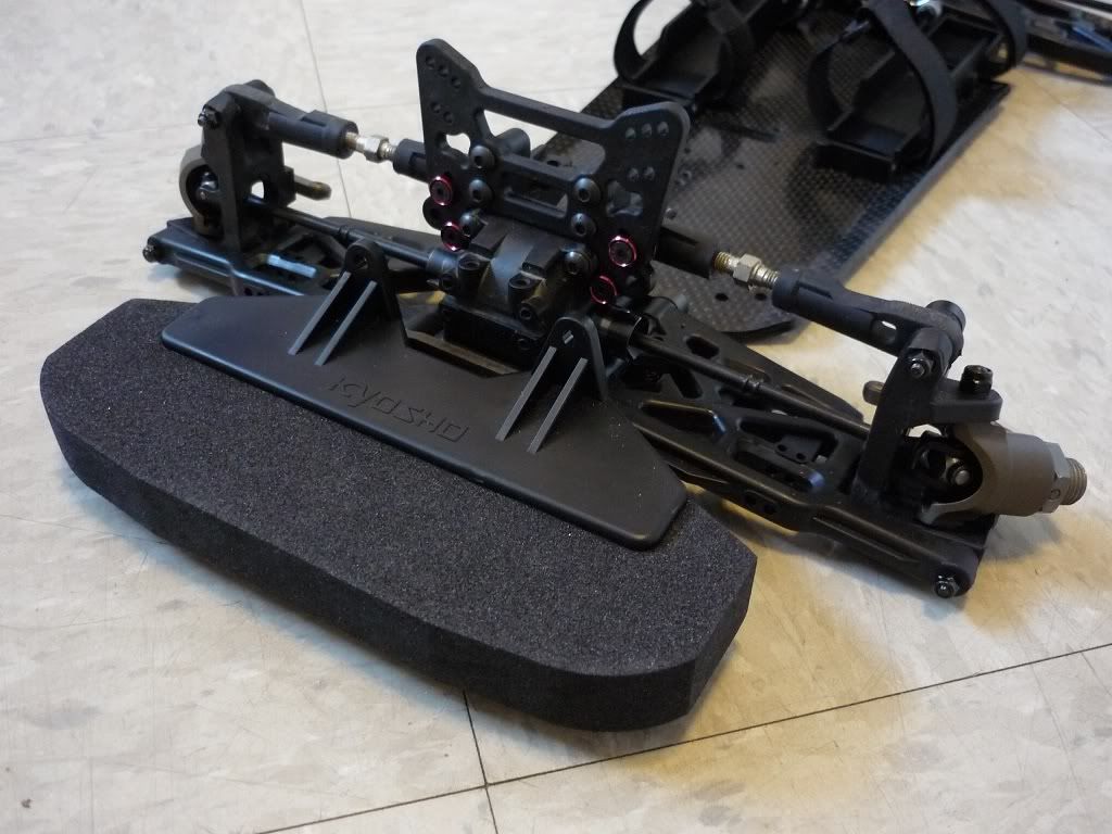

Should have some more pics soon of the whole thing actually assembled.

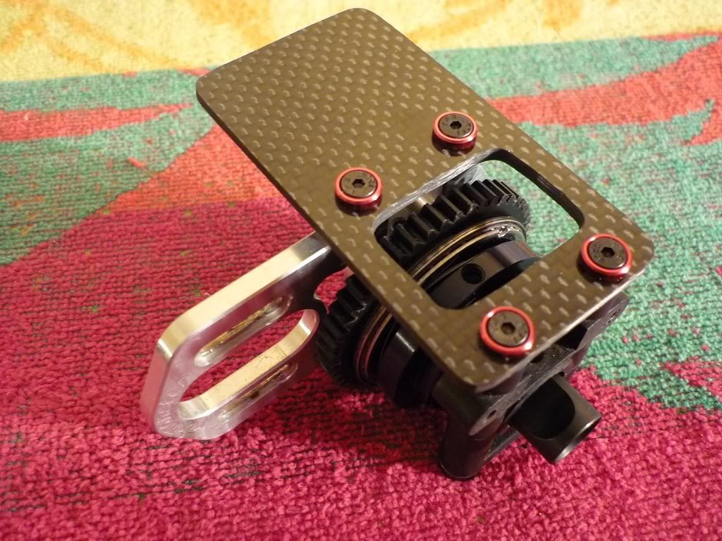

Today I used one of my pieces of scrap CF to make a center diff brace with an extended shelf for the ESC. It will extend out towards the front of the car, so I can use the stock length MMP wires without cutting them or adding extensions. With the ESC and motor mounted to the center diff, and servo and RX mounted to the servo mount I'll be able to remove the electronics from the vehicle with 7 screws, and won't need to disconnect any wires. This brace also allows much easier Slipperential adjustment with the lipos still in the vehicle, with a wide opening directly over the adjustment ring.

The only thing I am waiting on to finish assembling the vehicle are some stand-offs to mount the shocks. Those should be here in the next few days, then it's all systems go!
