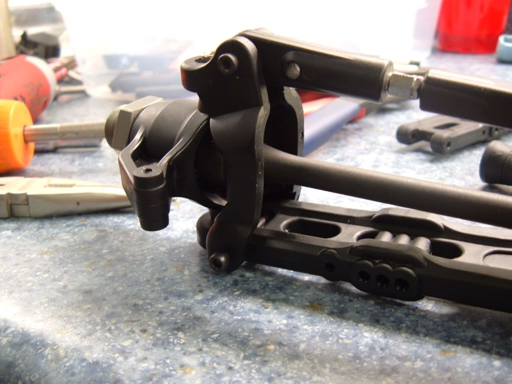

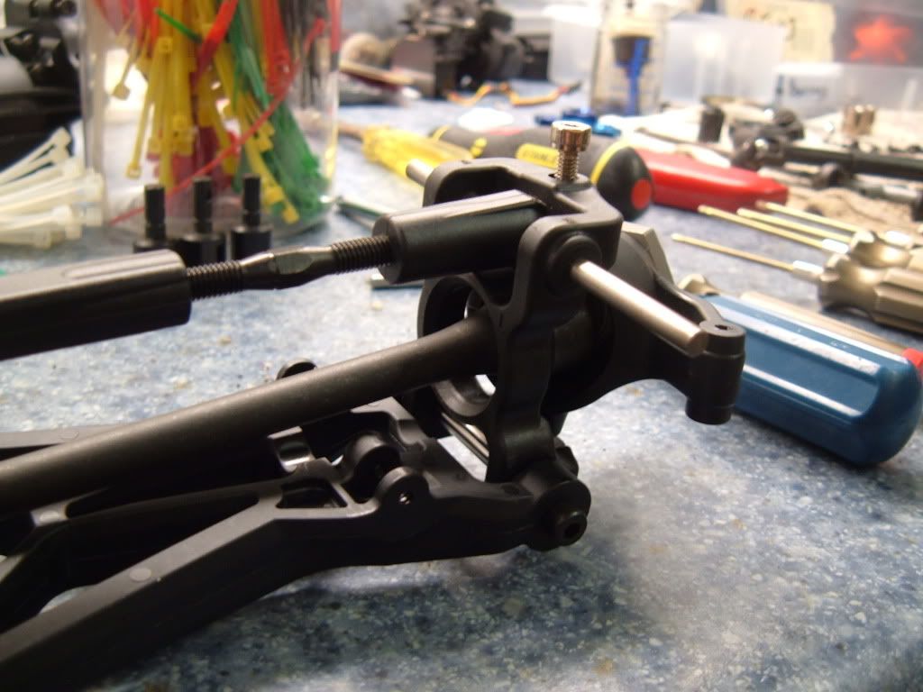

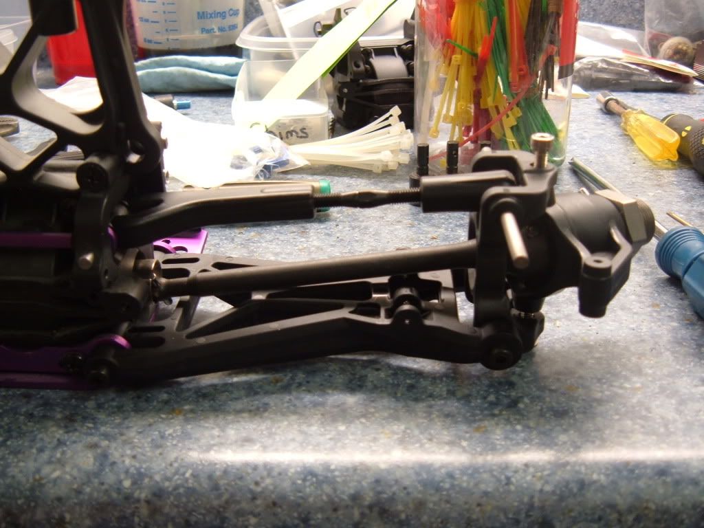

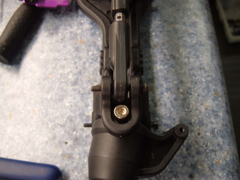

Pics:
Note the small spaces on either side of the upper arm, this is where the washers need to go:

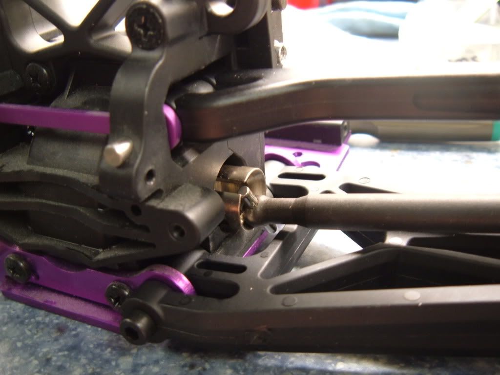

Diff output cup in pic is from a lst, but it is too tight in the diff case. The vorza cup looks to be identical but should fit the hpi savvy diff case better.

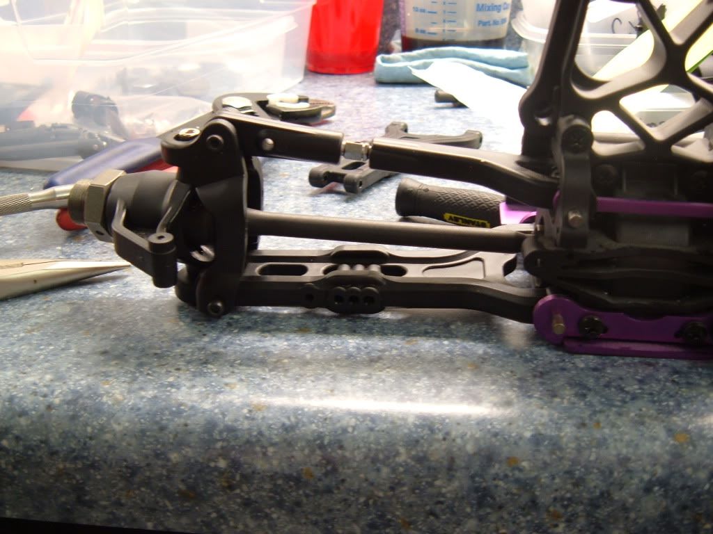

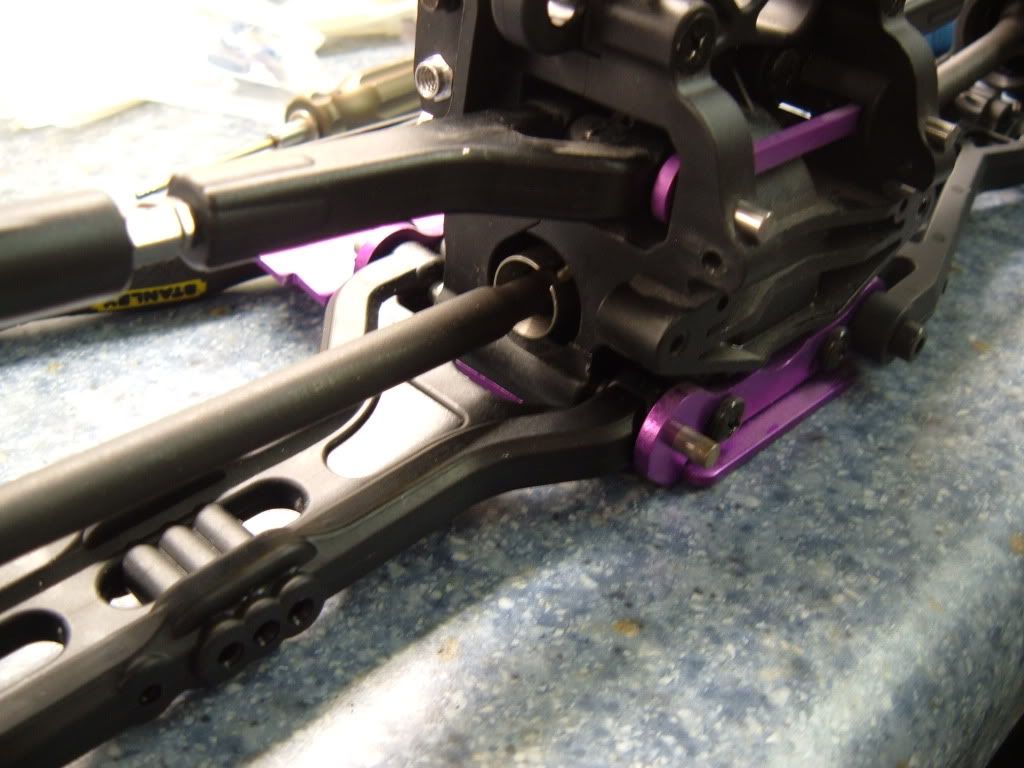

03.04.2011, 12:40 PM
And here is the lst c hub pics. The diff output cup is a stock X cup and it is the longest cup I have seen, and the pics shouw how the cvd is just not long enough.
