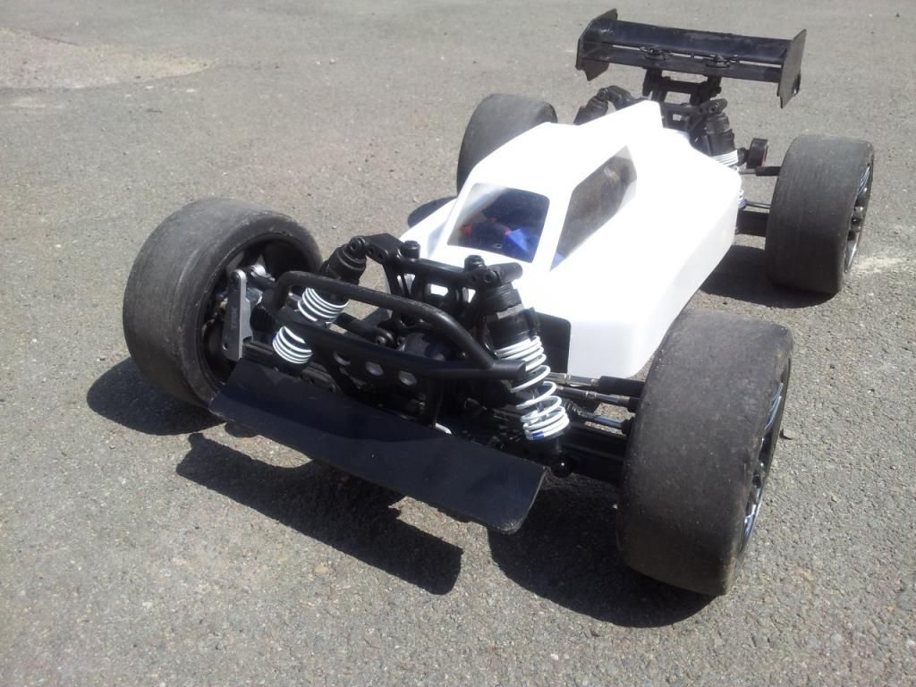

Some news.
The Alienpower ESC and the TP5670 are still not returned to me (despite me asking several times), but Bruno promised that I'll get it this week. At first he told the ESC will be repaired, now it'll be a new one because the old one was too heavily modified by me (?) Not sure why that is, I didn't do anything beside cutting the heatsink a bit and applying Plasti-Dip. Well, getting a new one is nice, but now I'll have to redo all the soldering and cutting the heatsink :(
Since the weather was getting better and I wanted to drive, I put the Mamba and the 1717 in again. Runs reliably, as always. Springs/Oil seems a little on the hard side now with the lost weight compared to the TP5670, but it was driveable.
Also tried out the new black-spoke GRP slicks. They look really nice, but traction is not as good as with the treaded ones. Ran it for a few minutes with a lot of throttle, after that the rear tires were almost too hot to touch. Clearly a sign for not enough traction :) Somehow I have the feeling, they are a different rubber compound.

Nice to see you got the Slash out again!
Crap to hear the GRP slicks have less traction (which compound do you have?)... :( I haven't tried mine and hadn't realized it yet, but reading your post and comparing the two compounds, the slicks indeed feel like different material, not with the "stickiness" of the treaded ones. Are those treaded ones in your comparison pic above also from this year, or from last year (just wondering whether they migh have changed all compunds for this year)?
Seeing your car again also reminded me I still have some work to do on my front wing :). I got a couple of wing options and I think I'll use a small lexan 1/10 ST wing. Looks most natural to me size-wise and is actually a very good copy of your design :). Still have to do a little trimming of the sides and will have to add some foam behind it for rigidity, but below is how it is going to look. Did you experiment with different angles of your front wing? Have you had issues with the car scraping the ground when on speed?

Yeah, really sucks with those GRPs. I tried the S3s and had the feeling they have less grip than the treaded S5s I bought last year and also this year a few months ago. Maybe the S1 slicks come close to the S5 treaded ones, but I think I'll just stick with the treaded ones, they always worked well for me in S3 and S5.
With the frontwing I seem to have gotten it right (or atleast good enough) the first time, did not experiment with angles so far. It sits pretty high, no problems with srcaping the ground at all, I also can go up lowered curbs in case I need to get out of the way when real cars approach. (BTW, it's really funny, I would estimate about 95% of car drivers actually treat my little car as a normal car that's bound to traffic rules and give right of way to it etc.) When the front suspension is fully compressed, there are a few millimeters left.

Yeah, I don't really understand why they would use different rubber for the Revos and the Slicks in the first place and then also not provide any indication that they do... Italians... :D.
Oh, I actually meant whether the front wing downforce would be high enough to compress suspension to the point the chassis/ front skid plate would touch the road; I think that would a good recipe for crashes, so I really want to avoid that... Anyway, maybe I'm just overthinking and should just get it out and test a bit.
I think it's cool how you just drive with traffic, I don't really have the guts to do so, which does limit driving options a lot. Not so many empty, long, straight and smooth roads out there :).
