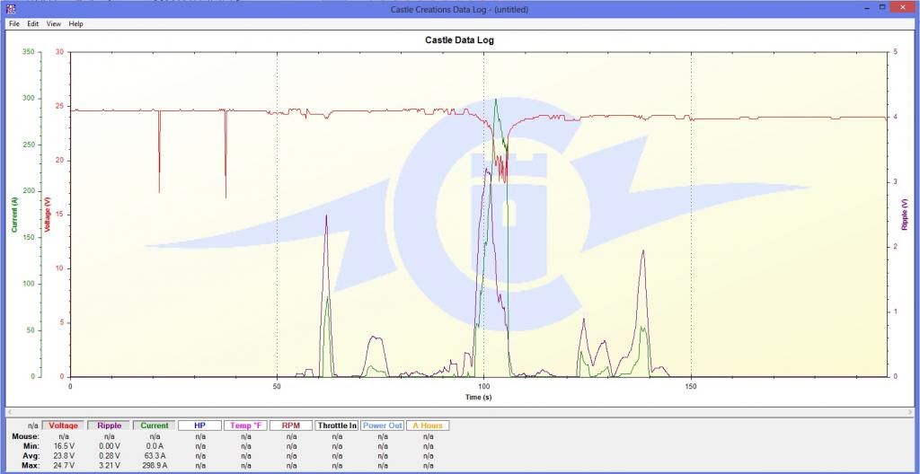

No data chart, don't have a data logger, but I have found this on another forum:
I'ts a HPI Firestrom with Poseidon 1717 2200kv Castle knock-off, gearing for 155mph and same weight as my Slash. Topspeed was 123mph.
300Amps would be about 6kilowatts. Assuming 90% efficiency (probably too high ...) this would mean 600W of heat that has to be dissipated somehow.
