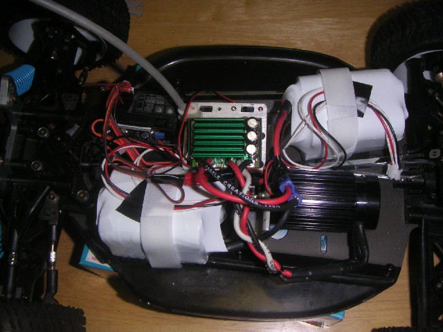

UBEC wires melted with 4S Lipos - 12.30.2006, 07:48 PM
Guys, I just ran my 4S setup and my UBEC wires melted, I thought it was a fluke, re-wired and it ran slow after a full charge an the same thing happened again. My setup is MMax with feigao 7xl motor, I ran my UBEC input wires straight from the 14V Lipos and the neg wire keeps frying. anyone see this B4?:035:

Welcome to the forums ;
That is odd, why not try putting the UBEC positive to the esc positive and UBEC negative to the the esc negative.

It may be that when you hook the batts up.
You are touching the red wire first. That would let the ubec be the ground.
I can't tell much by photo. Wires are everywhere.
Welcome to the forum though.

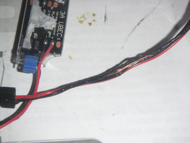

UBEC wires melted with 4S Lipos - 12.30.2006, 08:16 PM
Thanks Sylvester, I think that's what I've done, the UBEC pos and neg are soldered to the battery pack pos and neg and they are connected to the ESC input Pos and neg, I'll try soldering them straight to the ESC input wires in case I have a bad connection, but somethings drawing way to much current, check our my neg wire.

Sylvester
Sylvester's Avatar
Posts: 3,493
Location: Canada
12.30.2006, 08:19 PM
That doesnt look too good. Try just connecting them to the esc main wires and try again. BTW, what UBEC is that? If that isnt working too well maybe try the one mike sells.

DrKnow65
DrKnow65's Avatar
Posts: 998
Location: Colorado
11.05.2007, 09:32 PM
Are you wiring the bec to the esc??? You want to go from the bec to the reciever battery input. You don't have to power the esc, it will power itself without the bec.
