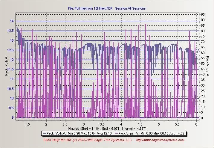

Just got done with the first run with it! 9 min and the temp was under 100f. I did eagle tree it but the ET temp loop slipped off and all I had for temps was an MIP onboard.
I was running a 13t/68t gear set and it seems a bit lower power overall than the Ammo with the same gears.
Here is the amp/volt data for the Medusa.

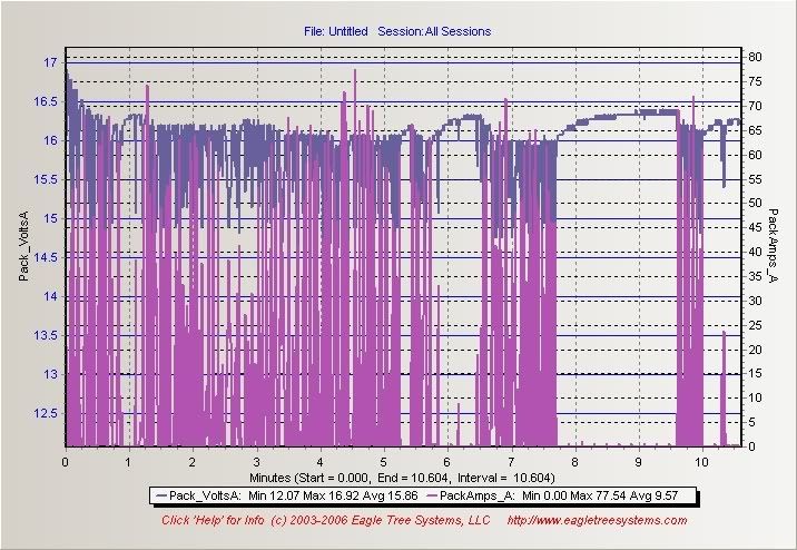

Ammo data graph.
Dang I'll need to redo the Ammo data I seem to have started on less than a full charge that run. I also had the ET set for a two pole motor so my RPM reading are goofed for the medusa run.

Interesting. The Medusa pulled less current than the Ammo. I wonder if that's because of its 4 pole design having an affect on the kt. Good temperatures though! Definitely looking forward to mine now. Since the Medusa is 4 poles, gearing up would probably wake it up some and get you some serious power (that seems to be what they like).
What cell count/type are you running? I'm guessing NiMH and 12 or 14 cells.

Sorry thought that was on one of the logs, I'm running a 5s2p A123 pack.

Nice. Thanks for the info on the batteries. I was wondering why the voltage didn't match up too well with NiMH or typical lipos....:D I forgot you said you run 5s2p A123s. D'oh!

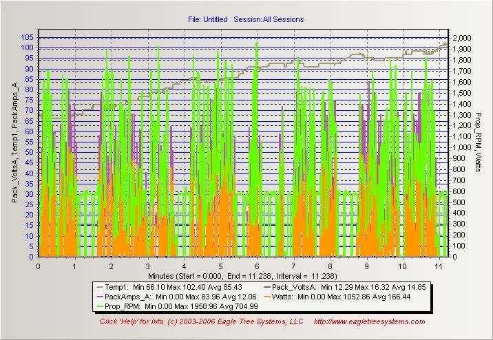

Just came in for another run this time on 14t pinion.
The puases are me checking the onboard temp guage I repositioned it and cant see it through the body now. The temp climed to 114.7 after I powered down. ESC temps peaked at around 140f
Power felt more on par with the Ammo this run, and its obvious the motor has more to give. Too dark to continue today.
Was catching some big air with it tonight. Cleared the two lane gravel road by a good 5' so I'm luanching it a good 30' long and 8-9' high, Awesome!!!
Forgot to mention the Prop RPM is wheel speed and I'm running Mulcher tires with molded foams so there is very little tire ballooning.

Wow, not too bad at all. 115 on the motor pushing 1000 watt peaks. Not too bad. From the graphs and the temperature, it seems like the Medusa is a pretty efficient little motor.
Thanks for the information buzzsaw. I'm quite glad I invested in one of these suckers now.
