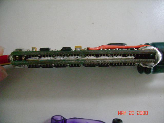

Originally Posted by johnrobholmes View Post
Do these have the same fets as the air version? Just different programming?

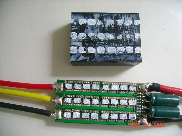

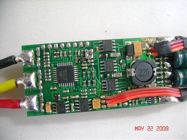

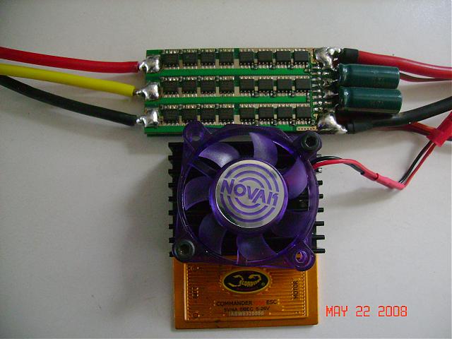

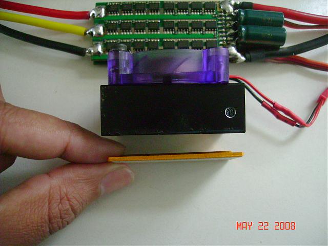

The FETs on the one I have are the NXP PHK31NQ03L. I have suggested another FET from NXP that seems a lot better as it has much less resistance then the ones there now. I have also suggested 3 or more powerboards to handle higher current. I will post some pictures of what I will do to the unit I have. Good thing my Schulze 18.97 failed as I'm going to use the heat sink from it and the fan from my Novak HV controller. I'll probably do a little box to fit the controller in and use some left over capacitors to make a big capacitor bank to see if it can help in the heat issue. John, I'm very impressed with this controller. All the safety features works, it went into the 50% power before it hit the Thermal cut off. The switching BEC works like a champ.

lutach
lutach's Avatar
Posts: 5,139
05.22.2008, 01:39 PM

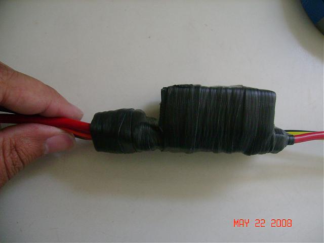

Some pictures.

Some more.

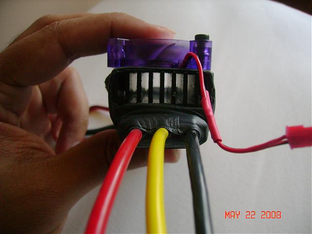

And more.

Last 2. Sorry.

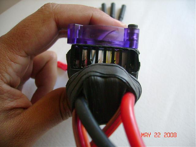

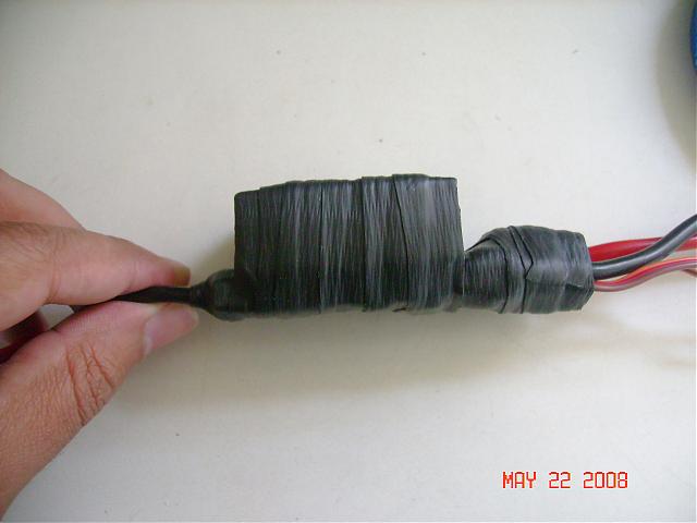

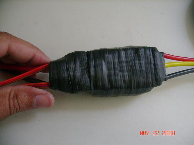

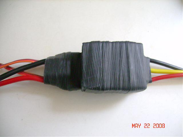

lutach
lutach's Avatar
Posts: 5,139
05.22.2008, 01:51 PM
Now let me explain the ugliness. I was going to use shrink wrap, but most of the controllers I have with shrink wrap seems to make it shrink some more. So I had some of that Self Fusing Silicone Rubber tape here and decided to try it out. One advantage is that it will withstand higher heat and it should harden a bit in a few hours. You can also see that it makes for a much more water tight application. It also smells like my uncle's rubber factory . I will find my on/off switch and add it to the fan and use my rx pack that's already in the truck to run the fan. I don't need the rx as the BEC on this controller is just doing a great job and hasn't failed yet. Hope your guys enjoy my Frankenstein job .

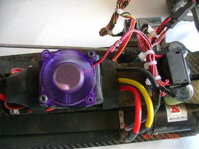

lutach's Avatar
Posts: 5,139
05.22.2008, 05:22 PM

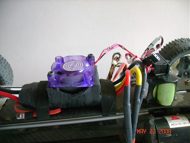

Got the controller mounted and fan working. Tomorrow I ill see how it does and hope fully it will stay cool.

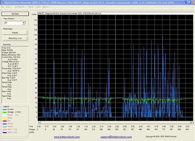

lutach
lutach's Avatar
Posts: 5,139
05.23.2008, 11:19 AM
Just came back from a quick run to see what was improved with the Heat Sink/Fan combo. I must admit, I've extremely impressed now. The controller performed very solid and didn't get hot at all. It was just warm and I guess the heat sink/fan made the difference. The Mega is getting a beating and it is just an awesome little motor. If Mega comes out with a sealed version of the ACn22 series, I'll be adding some to my collection.
