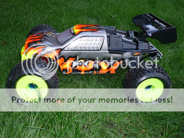

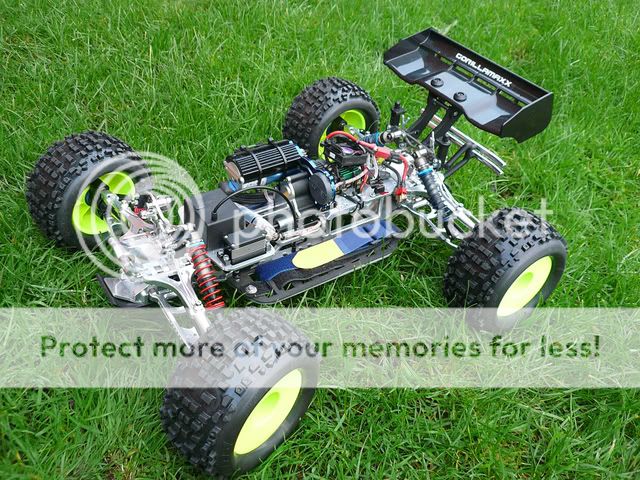

For the record here's my 2 year old Emaxx conversion which I'd rate as very ordinary, and truth be told hardly gets used as my brushless Truggies and Buggies are more fun to drive.
