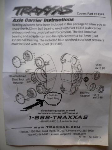

I read the instructions included with the updated 5334R Traxxas axle carriers and it's said these rings are bearing adapters required only if you use the inner bearings of the old 5334 Traxxas axle carriers which are smaller than the inner bearings of the 5334R model.

I wish I was at home to show you the instructions included with the 5334R axle carriers and which explains that these 2 rings have to be used only if you have the inner bearing of the 5334 model !! But I'm not at home
There are only 2 rings for 2 axle carriers because there is one inner bearing per carrier. That's why they are called "bearing adapters".

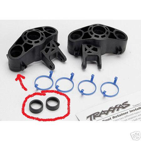

If you're talking about the 2 rings you surrounded in you pic then you're talking about bearing... I hate this discussion

NO ! there not for the God Damn BEARING ????

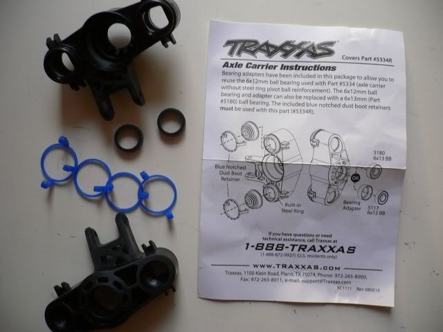

So let's stop here. I will post pic of what I want to show Friday when I'll be at home.

OK, Now that we have decent picture I can see where the miscommunication is.
I have circled the part I've ben talking about, this is what prevents the balls from popping out.
