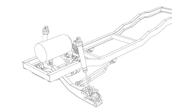

Somehow I found time to wonder into the shop today I've been thinking about this steering setup for quite some time and I figured for the first attempt I'd just go ahead and try to replicate the more complicated multi link setup. Haven't made a ton of progress but this is where it's at. Sorry for the cell pics.
Brackets mounted to the frame and steering links made for the knuckles.
Here's the start of the drop brackets. Top will mount to the brackets on the frame and the bottom drops down below the frame rails. If all goes well, the steering links connect to these then there will be a link that connects each side together. Then there will be one main link that goes from the servo to one side of the steering assembly to turn it. This should allow for minimal bump steer throughout the whole range of travel.

Alright. Made some good progress today! Still have some bugs to work out but I think this might just work.
Both the drop brackets are done and in place. I'm either going to have to reconfigure how the links are mounted or move the chassis mounts.
Here's a shot of the steering full lock to one side. I'm going to have to get some thinner head hardware because the clearances are pretty slim. It's REALLY close to being perfect though. I didn't have time to fab a cross link to connect the sides together. I will probably wait until I get the brackets in the right place anyways. I'm pretty sure I can get some rod ands that are a little smaller too.
I had to rig this side a little to get the bracket in the right place. Ideally I want the drop bracket in the middle of the chassis bracket so I have to rework this side.
The connection point for the drop bracket and the steering link is just barely below and just barely outside of the beam mount so the steering links follow the beam's travel almost perfectly.
That's it for now! I'll get some better hardware so the fit is better and see where I can move the mounts to make it work smoother. Then I'll make the cross link and mount the servo and give it a test.

Steering issues are starting to make my brain hurt so moving on to something else.
Specs are as follows:
- shock length extended 6.36" (47.75" to scale)
- shock length compressed 4.09" (30.7" to scale)
- Lower link length 8" eye to eye (60" to scale)
Here's sitting at ride height.
Here's the bump which is about 1.13" (8.5" to scale) of up travel. I don't think I'll get much more than this because the axle will hit the frame.
Here's the down travel. Drops out about 3.33" (25" to scale). So overall it has around 4.46" (33.5" to scale) of travel.
