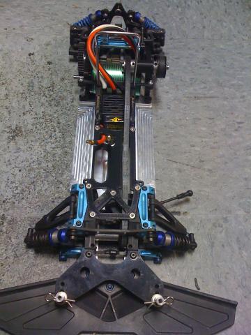

scratchbuilt
Posts: 6
06.27.2011, 01:03 PM
I had some people asking about the chassis. here are a few construction pics.

The Lipo is in the center? Can it fit a 4 or 6s?

scratchbuilt
Posts: 6
06.27.2011, 06:07 PM
As you can see the pack is a bit off center and the one shown is a 4s, 5200mah, 40c lipo pack from SMC. I used this pack because it has a similar footprint as the standard ROAR legal lipo packs. 138mm X 48mm X ?mm tall.

scratchbuilt
Posts: 6
06.27.2011, 09:11 PM
Originally Posted by superek4 View Post
Nice but it's limited to 4s only. If need to complete with gp the main is 1 Hr. A 6s setup is better.
That's been the latest debate. It's not a GP so why expect it to run a 1hr main.
It's electric thus it really should only adhere to an electric race program. 6s is definitely better, don't get me wrong but the cars are getting too heavy already. (diminishing returns). We find that we are adding more power just to overcome the added weight of having more power.
I could easily change the design to handle a 6s brick. Actually the design the way it is can handle 6s, 7s, 8s or whatever. It's really a matter of how the cells are designed and configured.
Several low capacity cells or fewer higher capacity cells. It's all a matter of give and take.
