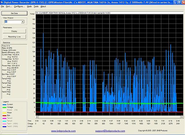

Did a good run today with the new 5000mAh 7.4v packs. Good thing the DPR-II-150 worked this time. I only ran it for 8 minutes or so. The MGM TMM 16016-3s ran smooth and cool. The packs were also cool and the Aveox was cooler than yesterday. This thread is turning out to be a battery test session than a comparison of ESC. I have to give my hands to MGM on making an incredible software for the controller. I have it set up on the following modes:
A: 3 (Car mode one way)
B: 1 (Light)
C: 1 (0.13 sec.)
D: 1 (Automatic)
E: 1 (Slow reduce rpm)
F: 1 (NiCd, NiMH)
G: 1 (3%)
H: 2 (Yes)
I: 2 (Yes)
J: 1 (No)
The other setting that I tried made the ESC act funny specially the J set to very light, it didn't feel very light to me LOL. Here is the data of this run.

could you zoom in at a few high amp peaks so we can see the voltage drop better. thanks

these cells are very good, around 3,6v @100 amps.

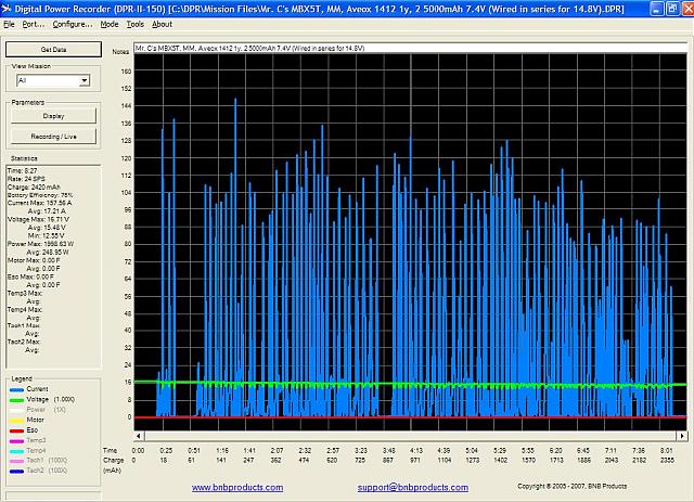

Ran the truck with the MM and it seemed to have performed better on 4S than with 3S. Power to spare. It wasn't as smooth as the MGM, but it seemed to deliver a tad bit of more power. Ran it for around 8 minutes and the MM was warm and so was the batteries.

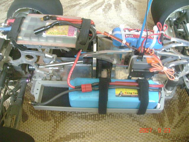

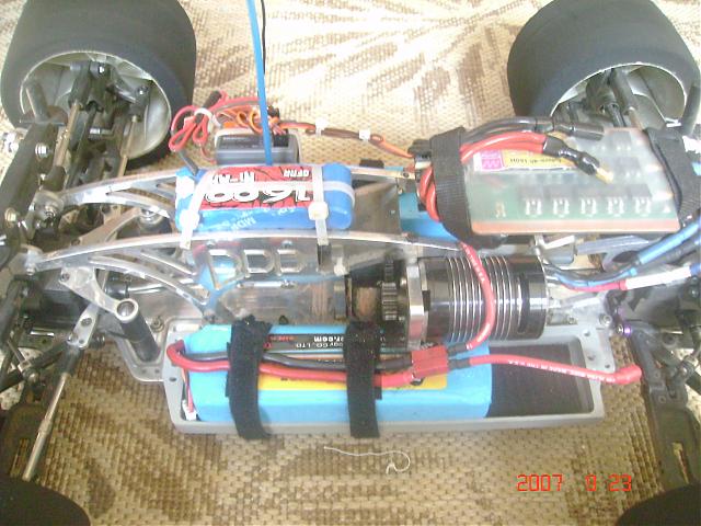

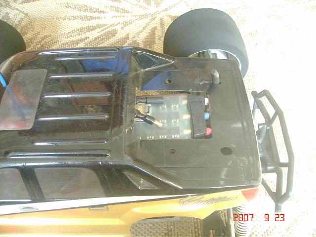

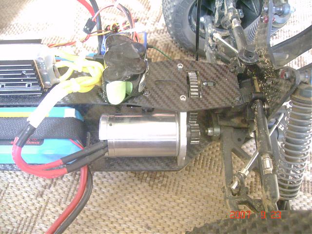

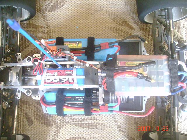

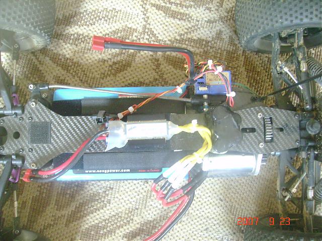

Some pictures of the MBX5T.

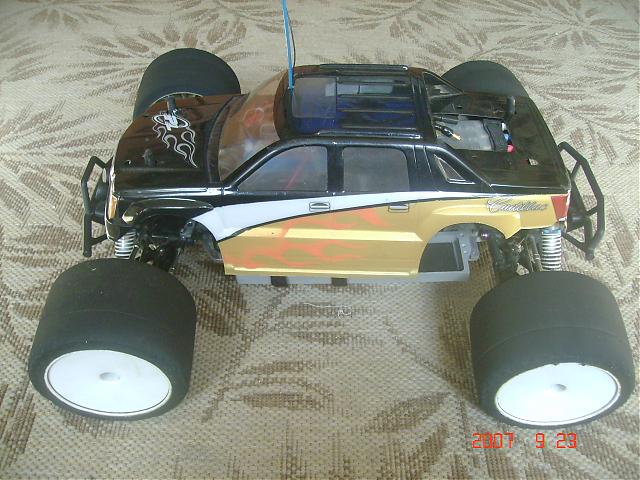

One more.
