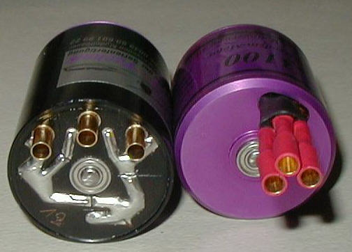

i honestly don't know the difference, other than you'll be able to change the wiring on the back, and you can't with the hi-amp. i have the same motor in a hi-amp, and i've asked what the difference is - other than the wiring options, and that the hi-amp is more expensive - and don't really know if one is more powerful (doubtful) or can handle higher amp loads.

Lehner recommends the hi-amp version anytime curent draw is expected to exceed +/- 80 amps. The motor are identical internally, but the hi-amp cannot be re-configured. :)

So is there anything i can do with my normal amp motor?Can I mod it to high amp?

no, you can't. The high-amp motors are build in a different way, you can resolder the back to make a star configuration instead of a Wye. (which devides the KV by 1.72)

HI..sorry about my bad english but i dont understand it all what u was saying about star resoldering?Help me whit this...What's the benefit of star conficuration?Any picture of how to do it?

brushless motors are available in delta (star) and Wye (Y) windings.
A delta wind gives 1.73 times as much torque and 1.73 times less KV than a Y winded motor.
Lehner non high-amp motors come in Y, but you can remove the original solder and reconfigure it as a Delta winded motor.
With the lehner non high-amp motors you have a motor that is a Wye wind, which can be soldered to a Delta wind motor.
This Y and D is also used for Neu brushless motors, the 1515 1y for excample. and they are also available in D.
