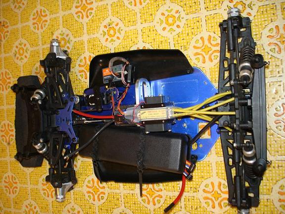

Seems we all have the same idea. IGT on 6S of TP V2, geared 44/25 thanks to Mike. Powered by a 224 MGM and a Neu 1527 1D. I dont have the motor pictured in this one, but it just dropped right in. Had to make sure the motor wires were at the top though.

12.28.2007, 10:45 AM
So, what motor mount did you use?

12.28.2007, 12:08 PM
I used the Kyosho mount from Mike. I will have you guys know that when I ran the 1527 1D on 6s, it was serious overkill. This chassis did not present enough load to generate any heat in the motor, and contrary to what most may think, and in my experience, I feared hurting the motor that way. I have seen what wide open throttle does to a brushless setup without a load. I now have a 1512 1D on the way for a 4s setup, and will reserve the 1527 for another project. Can anyone say 5th scale brushless.

So, it's the Kyosho mount. I assume no modifications were necessary to use it? I like the fact that the mount still allows the use of mechanical brakes...
  (#60)
myndseye
myndseye's Avatar
Posts: 72
12.28.2007, 04:35 PM
