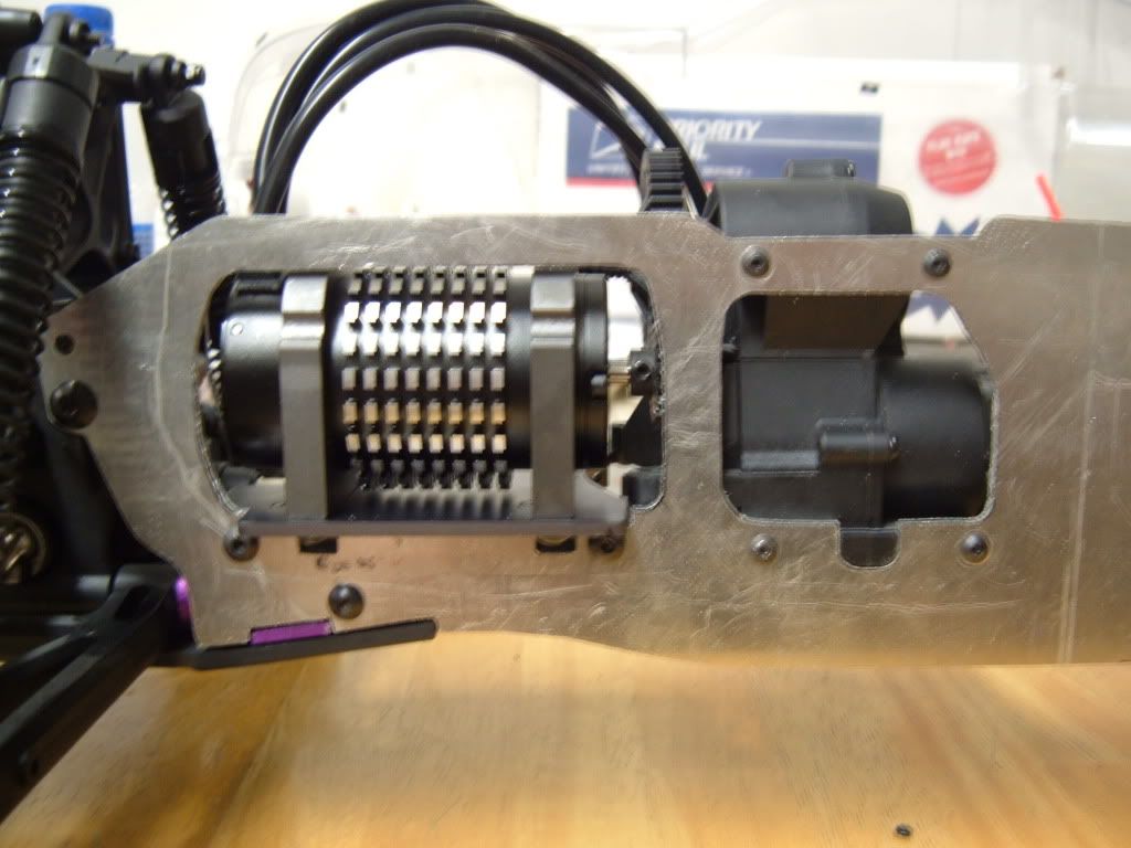

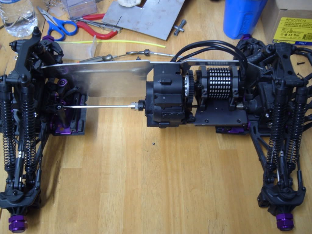

Ok, had to work a bit late, so I only got a chance to cut the tranny/motor holes on one plate. But being the nice guy that I am I decided to mock it up so that you all can have some pics.
Getting the rear mount on the flux motor was a real PITA. I had to bend the mount open and riddle with it till I got it on, then I had to clamp it closed with the bench vise... Crappy design IMO.

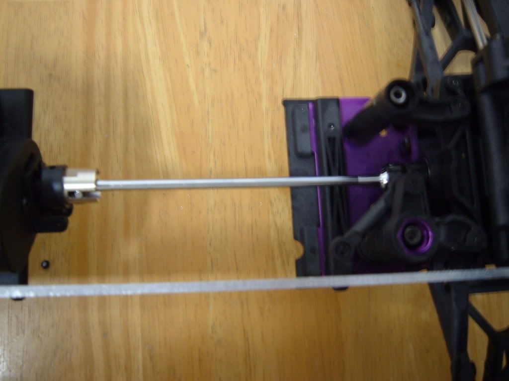

Any who, here is the closed to finished product. I put the driveshafts in to check fit, and all seems good. Using 20/47 gearing, and it may fit a 21t pinion, but that will be about it. Unless I go to a smaller spur, like the 44t stock flux spur.
