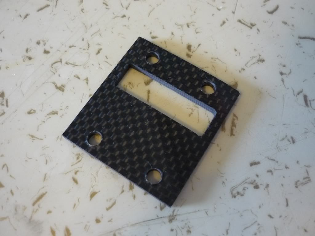

I made a CF center diff spacer today, which is needed because the diff is flipped around. It covers the stock spur clearance hole, and allows clearance for the spur on the opposite side. It raises the center diff by 3mm.
