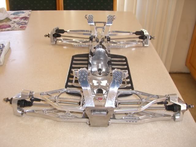

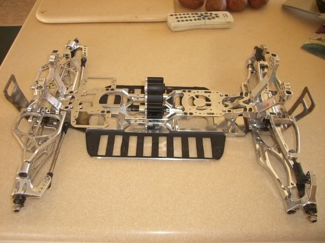

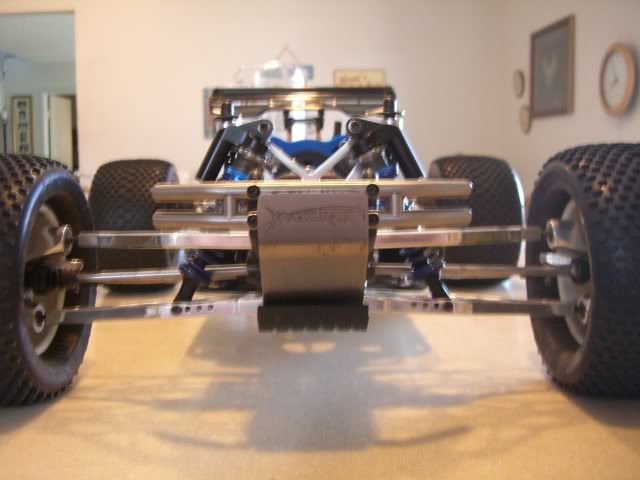

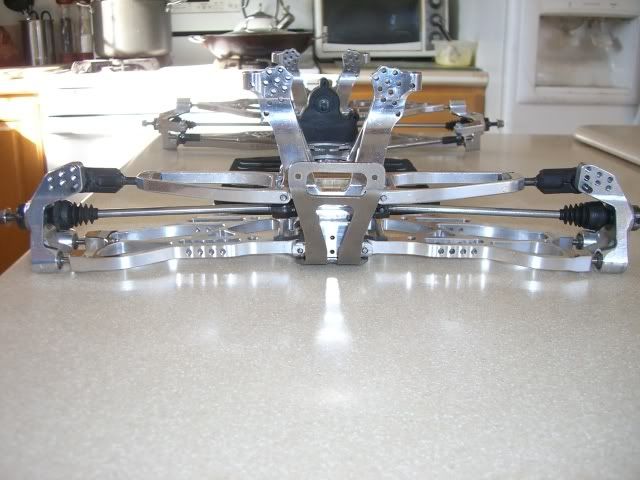

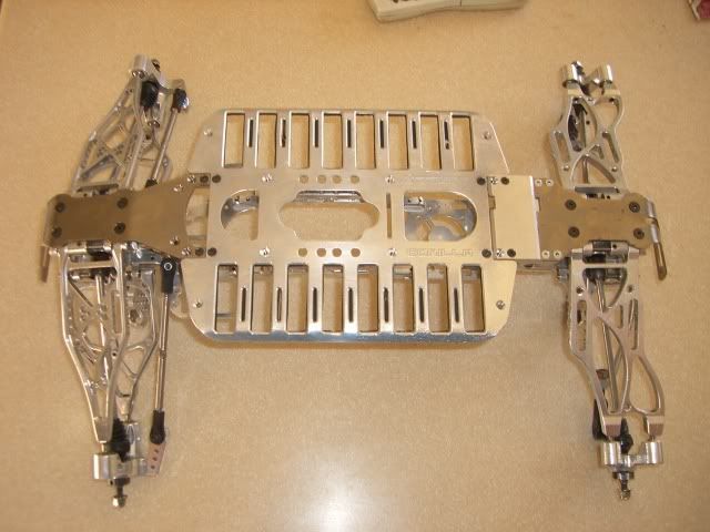

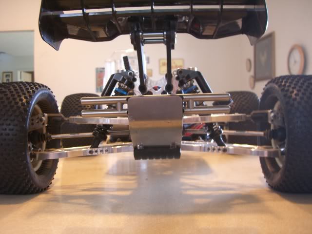

Finally finished and all I can say is Wow! way more power than I expected. I changed some thing around though like exchanged the vbs for GA bulks with sweetstrobes and UE 8 spider diffs. Heres some pics:
Look what I just recieved a g-4 chassis,it is about 10mm shorter than the g-2 maxx with the monoblock. I really like the layout and I think my g-2 and tranny is going to be sacraficed to the ISC competition thats being held in fontana ca in november. I just built this thing and now I am going to have to take it back apart again. Here more pics:

Nice Build!!! The Gorillamaxx trucks always look so bad ass! Anything special with your tranny. I keep breaking things in my tranny. The latest thing to go is the pin in the top gear. Why did you remove the VBS?

I did the pin mod and put in a solid pin intead of the weak roll pin. Other than that Its obviously a single speed g-maxx with a UE idler gear. I removed the vbs because this thing is too fast and if hit something @ 60mph+ I would just cry if anything happen to it especially @ ~$650 a pop not to mention no spare parts are being made anymore. So put it on my now full blown nitro supermaxx that I dont plan on running that much anymore. I also want to lower the body more and the vbs towers wont allow this and duh titanium towers will. Who knows I might put it on the g-4 maxx chassis because that will look awesome. Here the pics of the vbs setup that my previous links broke on earlier in the thread:
