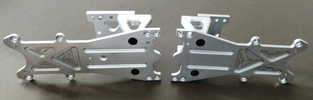

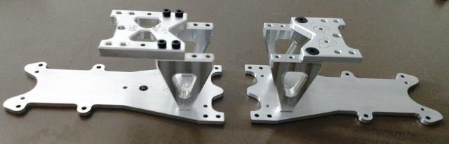

50mm extension done
  (#79)
RC-Monster Mike
Site Owner
RC-Monster Mike's Avatar
Posts: 4,915
Join Date: Nov 2004
Location: PA
50mm extension done - 07.23.2015, 01:41 PM
Shown next to the 35mm for size comparison. :-)
