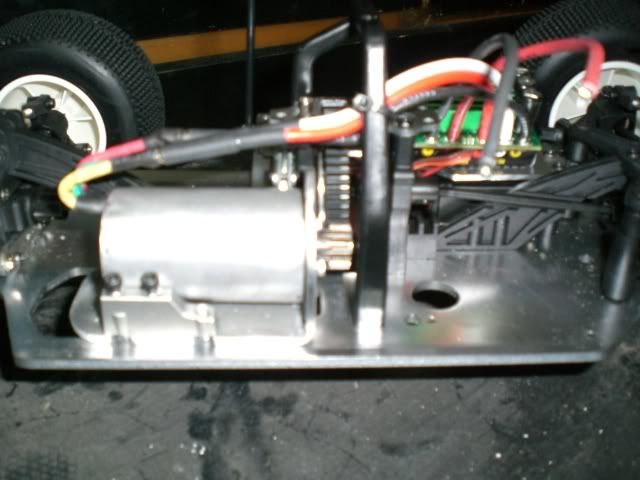

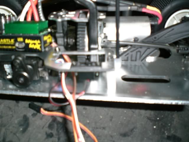

sorry i had to wait so late to get pics up. seemed like everyone in my family needed something today which took all my time. any way, heres where i stand now. mamba did come in today so i found its new home. it'll rest on the plate above the steering servo. you can see in this pic my layout. i'll also use a pair of 4s1p for juice. one on each side of the car.
here is a pic of my throw together motor mount. it seems plenty strong so it might just hold up. also you'll notice due to my lack of hardware and taps, i used the nitro motor mounts to hold my new mount inplace.
i'm really happy i came across this idea. i noticed with most setups everyone cut the servo mount plate, but i'll be using mine. i was able to use the on/off switch hole for the mamba's power switch, it gives me a spot to mount my rx, and the best part is i took the gas tank mount and used it as a support on the end. i simply flipped it over and there was a perfect hole there for my antenna mount.
this is all just rough fitted for now. i have some clean up work left while i'm waiting on my batteries and bec. i still have to remove my breaks also. but this is where i'm at for now.

I like your motor mount, only thing i could see would be that it might be lop sided once you get your batteries in there, might not even be notieable. btw what kind of motor are you using?
oh and the reason we all cut the throttle/brake servo because we all mounted our motors on that side and if got in the way lol, thanks for the heads up on the switch mount i still have the piece i cut off so ill use it to mount my switch also.

the motor is a feigao 10l. i didn't like the purple so i hit it with the brush. i kind of thought i would have a good balance with this setup as opposed to all my batteries on one side. my other thought was if it felt unballanced, id turn the motor around and put both packs on the rear.
