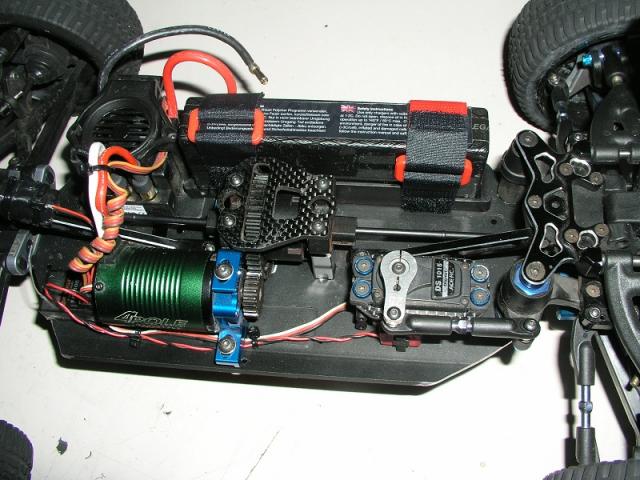

04.06.2012, 02:35 AM
Well the only reason for the 1415 .5Y was the Y winding
I would run the motor with torque control propperly set to 5 or below
I don't need the power but I like to have a Y wind motor...
I have a local dealer in germany that does sale Neu Motors, but the 1409 1.5D is not in stock since a long time. but the price used to be great 185$ incl. shipping
PN me about the 1409 maybe we can work something out ...
How long are the cables ?
