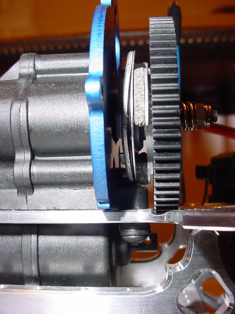

The 3905 tranny bolts in place from underneath, but since the flm chassis is thinner than the stock plastic one, the bolts will stick up further through the chassis & tranny mounting points; I'm guessing they catch or rub against the back of the spur gear / slipper mechanism?..
Yes, you are correct.
Before I realized what was going on, the screw came through and crushed the backer plate to the slipper.
The top plate being so thin is a concern of mine.
It's only about 1/8" thick to begin with. There's ALOT of material removed so the spur gear will clear. It's VERY thin there.
Where the top plate bolts up front and rear, on the top, additional material has been removed. This makes this stress point less than 1/8" thick.
If the top plate were made from 1/4", it would have negated several issues.
I'm building it and will put some serious torque though it. The Mamba XL and 8S Lipo will make sure of that.
We'll see how it turns out.

There's very little clearance there between the tranny and the slipper.
This slipper is shot.

Okay, I see. Well, I noticed that too and just used a shorter screw for that particular hole.

There are some small spacers included with the kit, but they are made for countersunk 3mm screws.
They won't fit the non-counter sunk larger transmission screws.
