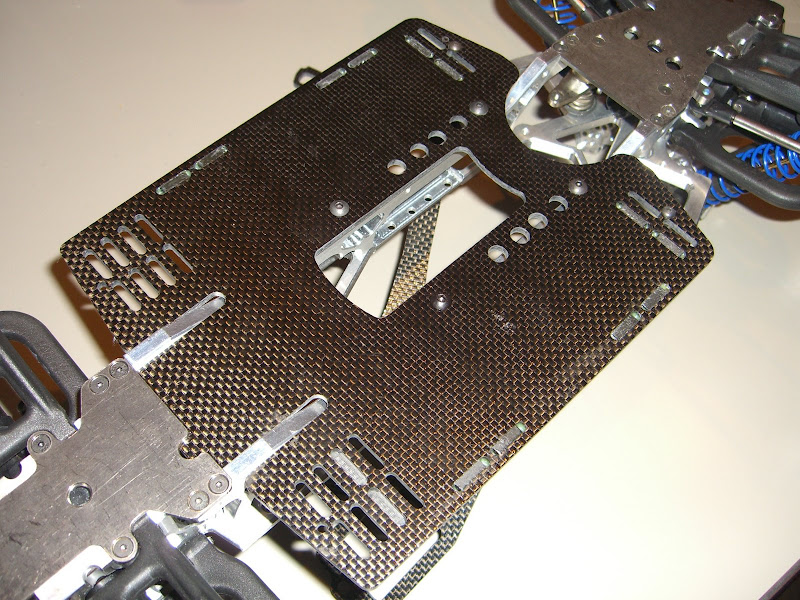

Here is the result of a plan i had for quite some time now. Had the drawings for a longer time, but never had a change to have them machined.
Today i jumped the opportunity and took my carbon sheet trough a CNC mill!
In the attached PDF is the plan of this 'conversion'

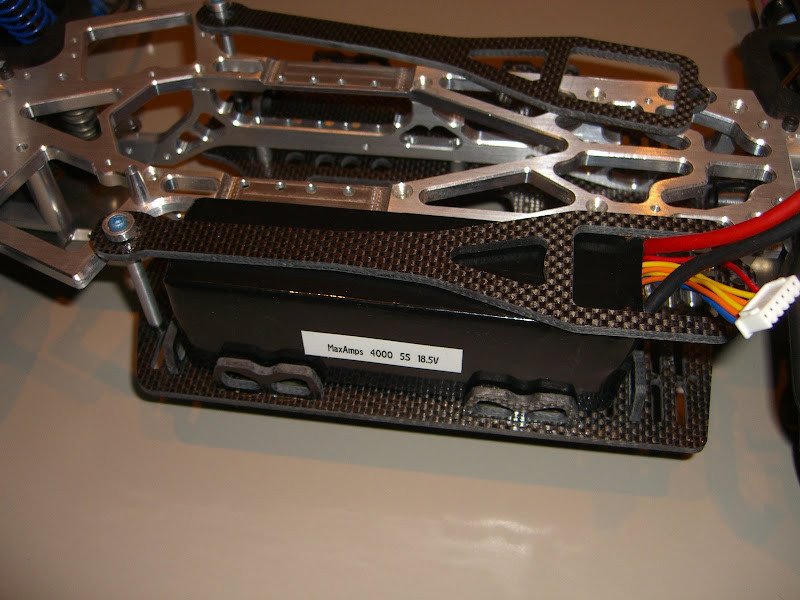

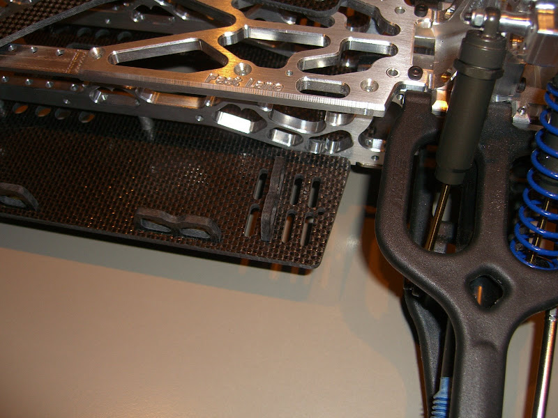

What i did was cut off the battery 'ears' of the flm chassis with a handsaw, used a wood router and a 45 degree bit to get the chamfered edges. The holes in the braces of the chassis changed from M3 to M4. the end of the lower plate is resting on the rear skid.
my intention was to make a lower CG that was compatible/adjustable with the different sizes of lipo packs.
I like the low CG of the gmaxx chassis, and the bashing thing about the FLM..
Anyway, here are some pics..

Planning on putting an actual motor in it and run it on 5S2P..
think I'll put a 1950-8 or a 9 or 10XL in it. she will use the traditional 2 speed transmission.

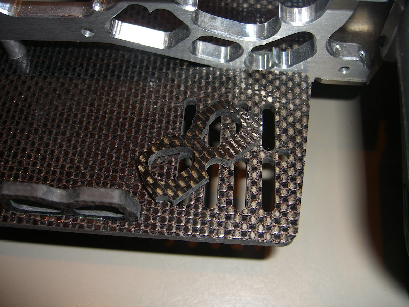

4 of the 8 stops are held in place with 2k glue, and the other two (length) can be hold in place by a lexan 1.5 mm thick sheet, that presses the plates in, and lays under the battery to press them tight in place.
it would be an option to make the braces from aluminum and use button head screws to hold them in place.
It would be fair cheap to produce if you have them laser cut.
