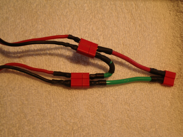

I have an E-Revo, Feigao 8XL, MM ESC, Medusa BEC, standard gearing. Initially, I ran two (brand new) Venom 6cell 4600 packs in series. I was able to experience the power of 14.8V, but it only lasted for 2 minutes - that is no exaggeration!
Attached are the photo's of my setup (series harness). Please help as I'm sure I should get more than two minutes of runtime.

Oh, I took new pics of my "series" plug for the NiMh's.

Your Y adaptor looks OK, so no problems there.

I think I figured out the problem. After consulting with the LHS "expert", he checked the resistance on my series connector - it was good (<0.002 ohms), he recommended cycle charging the battery. I put it through a complete Discharge/Charge cycle (both NiMh batteries) and ran it today for ~11 minutes. That's 5 times more run time than before.
