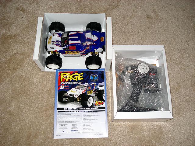

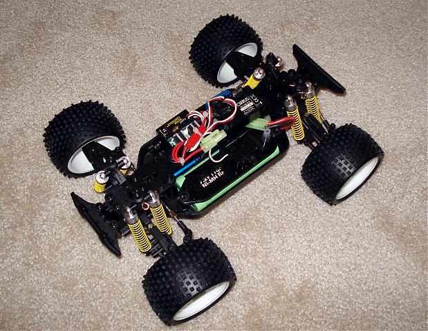

Just got mine in today! It looks good so far. At first glance it looks exactly like a Mini Quake chassis, but there are indeed a lot of little differences. I plan to break down the chassis tonight, but before I do that, I want to get at least one run in with the truck in box stock form. I'm currently waiting for my first charge to finish, so I'll give you guys a little feedback of what I think so far.
Shocks:
As most of you already know, this truck comes with 8 oil filled shocks with aluminum caps. The shock bodies are made of plastic and they are filled with what seems to be very light oil. The shocks are held in place by a 1.5mm st screw up top and a kingpin/e-clip combo on the bottom. nothing new here. Finally, the springs are similar to the stock white MQ springs in stiffness.

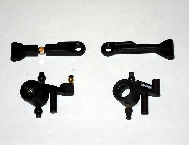

Lower arms
These look identical to the mini quake, yet are slightly different. The plastic seems to be made of a different compound, but is still flexible like the MQ arm (which is a good thing).
Upper arms
Simply stated, they rock. They are two piece arms with an aluminum tie rod installed. Camber adjustments are finally possible. This is a much appreciated upgrade. The plastic on the upper arms are also thicker than the Mini Quake upper arms.
Knuckles
Not much to say, except there is an additional ball stud hole for extra toe adjustments.
Shock Towers
Are very similar to the MQ, but have a slightly different design. More plastic is used and there is no upper chassis brace mount since the Rage uses an upper deck.
Upper Deck
Seems to be made of 2mm thick fiberglass. I like the concept vs the MQ upper brace, but it needs to be stiffer. A good 3mm carbon fiber upper deck would fit the bill nicely.
Wheels/Tires
Another high point of the XTM Rage. The wheels have a nice wide off-set and the tires have a pin type pattern with a very hard compound. Good for its main use: bashing. I also think these would be good in damp/wet packed tracks. For dry or loose dirt, you're going to want something else. MQ and Vendetta ST tires should work on these wheels. If you need tires for racing, I suggest a visit to the Vendetta forum and read Jaejw1's tire review.
Battery/Charger
The charger is your standard cheap-o wall type charger. It has no peak detection and there no led to let you know if its even working or not. The charger has an output of 0.5 amps. The battery on the other hand was a nice surprise. On the back of the battery you can clearly see the manufacturer: KAN. These guys are one of the better nimh manufacturers, so I expect some good results from this pack. *edit: A few other things. The battery uses a mini tamiya connector (?), so a standard 1/10th size tamiya plug will not work. The battery also comes with 15awg wires which is actually thicker than most. Not bad...
ok.... that's enough for one post. Here are some pics... enjoy.

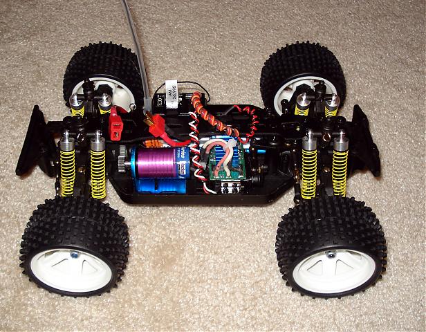

I just finished mounting the brushless stuff to my Rage, and still running with the stock battery. I also removed the crap stock servo that stripped its gears within the first battery, and replaced it with a Hitec 225MG - which is a fair amount larger than stock (required modding the chassis).

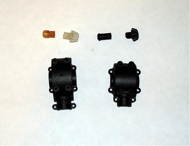

Drivetrain:

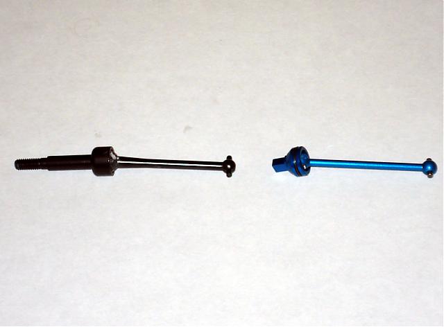

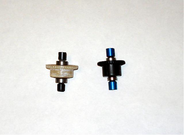

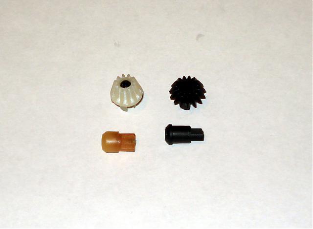

The Rage comes equipped with steel cvd's in the front along with steel dog bones in the rear. This is a pretty trick feature if you consider the price. No other RTR mini features steel cvd's at this price point. Nice job XTM, you get points for that. The dog bones work fine, and upon closer inspection, seem very secure. I don't think they'll fall out unless you break the arm. Ok, I do have one gripe though. The steel cvd's are not the highest quality. They are strong and get the job done, but you won't mistake these for hudy spring steel. The cvd's are not very smooth and required a bit of sanding (by hand) and lubrication. I used dry teflon powder to lube, since this is an exposed part. Also, if you decide to take apart the cvd. You will need a .005 hex driver (I believe) and very steady hands. Don't strip the grub screw or you'll be kicking yourself. I also have a pic of an XTM cvd next to a MQ cvd below. Please note that in all the pictures, the XTM rage parts are on the left and the Mini Quake parts are on the right.

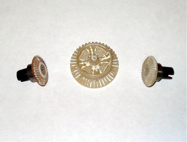

The Front and Rear diffs are open style gear diffs. These are actually thinner than MQ and are NOT compatible. Ok, everyone say it all together now.... "BOOOO, HISSSS, GRRRR, ....... Hey Batter... batter... Swing"!.... [&:]... I actually noticed that the diff housings seemed a little thin from the outside, so I was expecting something different. To be honest with you, I'm not impressed at all by their looks. They look cheap and brittle, and one of mine is white while the other is an off shade of yellow...? There are two things that can cause this during the manufacturing process. 1) not blending the plastic pellets well enough before injection molding, resulting in an uneven batch color. 2) melting or injecting at a very high temperature causing the plastic to discolor. Either way, the plastic used doesn't look good, but seems to work fine.
Ok, here's the silver lining in a so far dark cloud. The outdrives are made of steel and are fastened to the bevel gear with a screw. This is actually one of the high points on the diff. Good outdrives. Gearing on the diffs is significantly different from the Mini Quake. The front/rear diffs of the XTM Rage are geared at 12/41 vs the MQ's 15/38. This gives allows the Rage to have better low end performance and faster acceleration. Add another point for XTM.

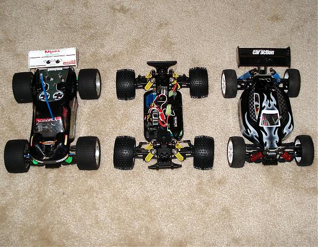

Almost forgot... more pics.

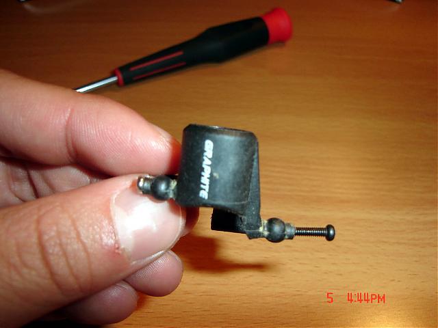

- I also modded the knuckles with some screws for extra strength. (pic is of a MQ knuckle, but same thing applies for the Rage)
you will need a 1/16" bit with a 2mmx10mm screw. You may also need to dremel off any exposed screw on the inside of the knuckle.

Rich, how is the stock servo holding up for you? Your Rage has a lot more power than mine did when one of the servo gears stripped. Also, how are the temps on your Mamba 25 with that heatsink?
Last night I drove around my Rage with the KMS 2213 3200kv outrunner (about 28mm outer diameter and 25mm length) on the stock battery and with the Mamba 25. I had to change some settings around on the Mamba 25 to get it to run well, but then I ran into a problem - the stock battery can't dish out the power required by both a Hitec 225MG servo and the outrunner motor (even though it was only geared for ~20mph). Tonight I will see what my 3s Lipo options are from what's available at Hobby People, but I'm guessing there won't be much.
