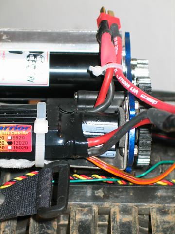

I have a simple soldering question. I have a 12020 controller that has double wires for each connection. My soldering skills are basic, and I think it may be a weak link. Set up E-Maxx 12020/Feigao 7XL/ 14T pinion / 51T spur / stock diffs. I am finding that the motor skips at full throttle. I am suspecting it's the soldering.
1. Deans connectors - I twisted the two wires together annd soldered directly to the connector. A huge clump of wires to the little connector. WOuld it be better to solder a short single deans battery wire to the connector and then twist the other end to the two 12020 wires and solder?
2. Connecting to the motor. The wires on the motor are presoldered. I tristed the two 12020 wires together soldered them and then soldered the motor wire onto it. Would it be better to "sandwich" the motor line between the controllers and then solder?

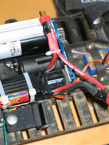

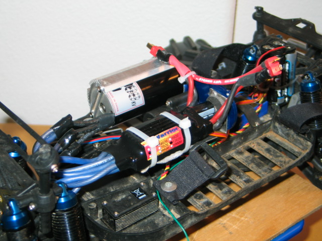

03.13.2008, 09:52 PM
Here are the pics. On the battery leads, you will see a black and red wire solder3ed together....it is not a mistake. The neg and pos wires are correctly together.

Glitch may be the key word. Your radio antenna being sandwiched between all those motor wires could very well be the problem.
I wouldn't suspect the soldering if it takes off hard and only has the problem at a higher RPM, as most of the amps are pulled getting the vehicle into motion, not as much speeding it up...

Did it glitch before, or just start reciently? I see what you mean by wiring everywhere. You could cut the shrink wrap off and unsolder some of those leads, and shrink it back with clear 6 cell stick pack shrink wrap. But otherwise nothing looks as if as Drknow65 mentioned, the antenna wire being close to the ESC may be the culprit.
Another note, if your BEC circuit is being starved by the motor that will cause it to glitch too, some ESC's have a weak BEC circuit, some have had to add a capacitor or studder stopper to RX. http://www.horizonhobby.com/Products...ProdID=SPM1600

Thanks for the great input. I went out and ran it today, moved the antenna to the back. The jerking (I dont think it is cogging) is on the start. It will hesitate then go.
I had a UBEC on it and took it off and now have a battery pack going to the controller.
So I cna unsolder some of the leads and just run one lead? That would be much easier.
