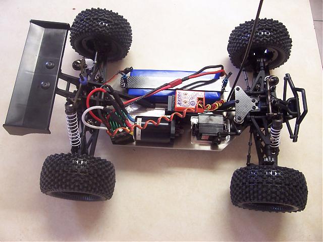

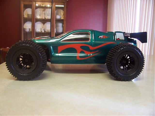

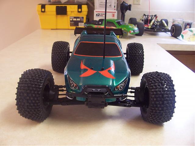

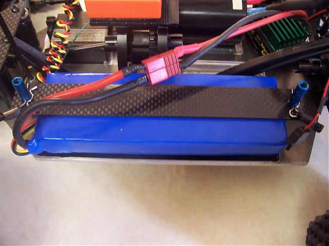

Thought I would post for your enjoyment. Suggestions, comments, and questions are welcome.
The rundown:
-custom cf batt tray and front top plate (I wanted to move the front brace out of the way of the driveline.
-custom fabricated 1/8in 7075-T6 aluminum chassis milled to reduce weight (I used the on campus shop at Utah State University where I attend school). The chassis was extended 14mm longer than the standard rc-monster chassis because I wanted to get closer to 1/10th scale hopefully Mike will soon get the extended a-arms done. I am also having Mike make me a custom extended bone for the rear.
-Jato body, this was my 1st attempt at doing multi colored scheme with the help of XXX masking (I know it bled in some spots. Now I know what to do better next time)

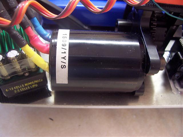

-And of course the neu 1509/1Y
Ren

Your CRT.5 looks great. Nice work on the chassis. When you get it running let us know how you like the 1509 1Y. Are you going to run it 2S or 3S? I'm thinking about a 1506 1Y for my RCM CRT.5 and 2S batts.

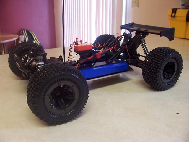

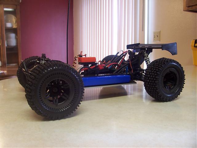

I am running 3s 3500mah lipos in it, on a 15t pinion geared for 45 (I know, a little high). I am also using the full sized crt origional wing (dyed black). I also made a custom rear body post.
I am stoked to run this thing.
I am including a few more pics as well, and will get video when it is up and running.

Your crt.5 looks great. Definitely want to see how it runs with a 1509. That will be very fast. A few 1/8 buggy guys are considering 1509s (on 4S) for a motor that will be very competitive with a good .21 nitro.
