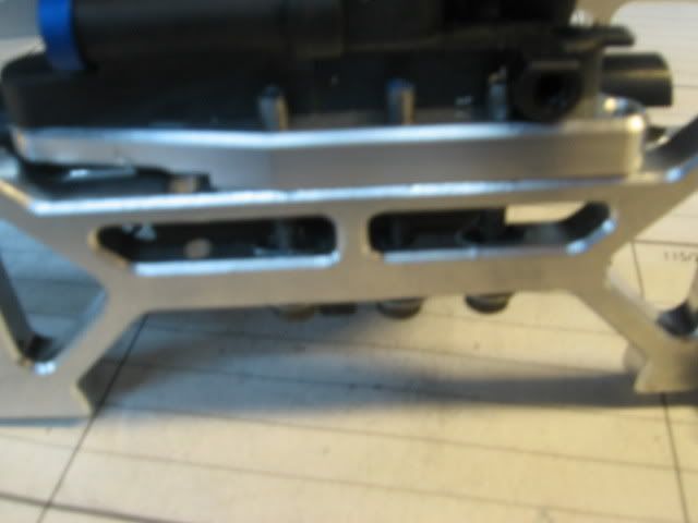

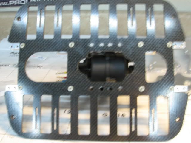

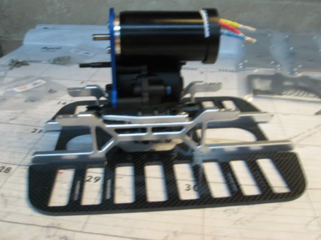

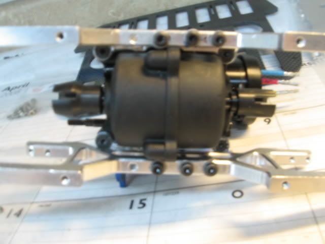

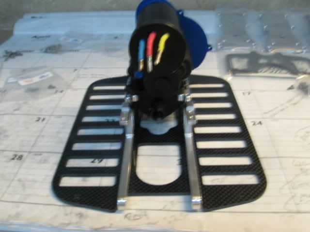

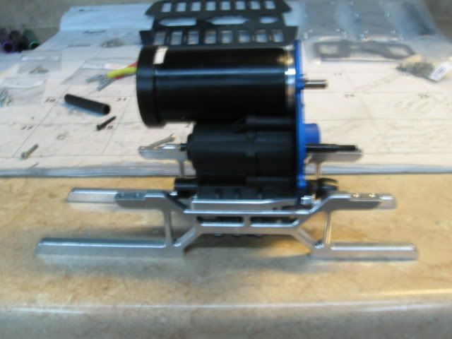

I'm totally stocked (And a little tipsy) at the moment, I did want what said couldn’t be done, I installed a 3905 trans on a GorillaMaxx 3.0 chassis..
Here how I did it just incase you want this mod your self?.

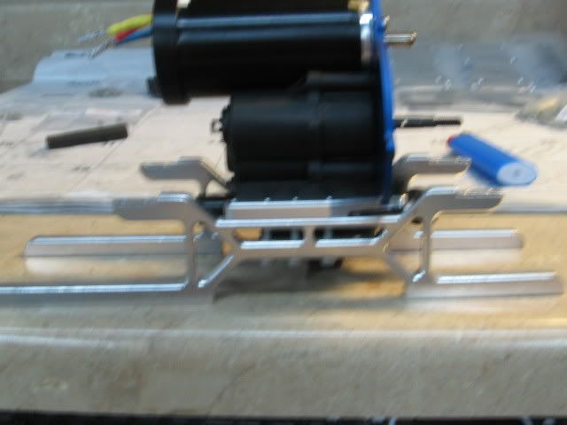

I bought the FLM 3905 Transmission adaptor part # FLM10600 for $17.00
(For what it’s worth) this little mount allows you to mount a 3905 on the FLM chassis..
Anyway I simply drilled another hole as close to the original hole as possible in two locations and got out trusty dremel and cleaned it up!. I don’t have (4) screws holding in the transmission down but I don’t think that will cause a problem?!.. (your thoughts)

That looks fine, I wouldnt worry about only using 3 screws on either side- its goin' nowhere. Im sure with a few tweaks FLM could make a version specifically for the Gorillamaxx chassis, though GorillaMaxx themselves are said to be working on a chassis specifically for the 3905 tranny, so.... cool either way.

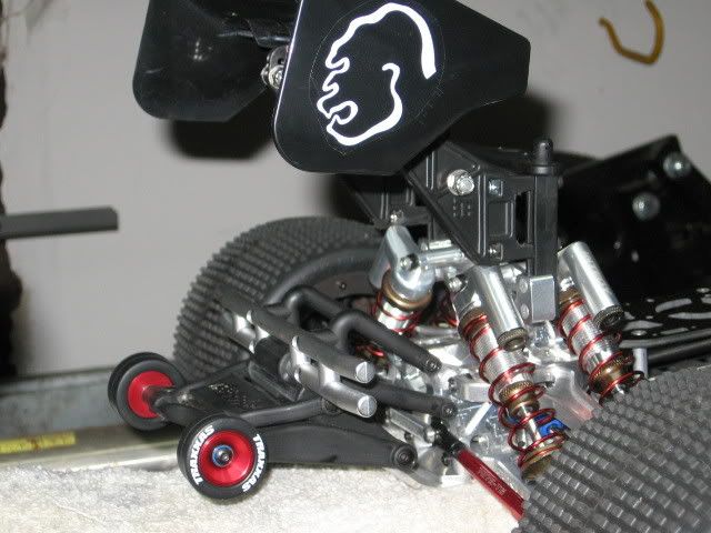

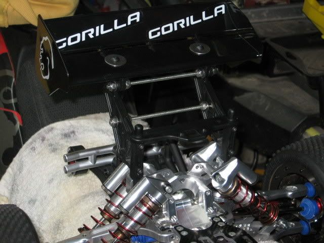

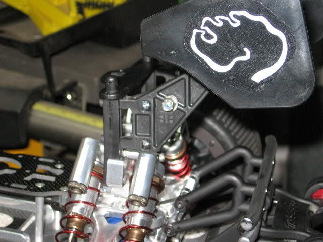

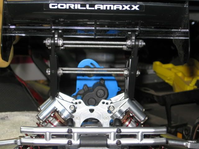

Here is another modification I just completed for my G3. I was able to install the Tenko wing mount with some basic parts I pickup at the hardware store..
I just need my MMM and it good to go..

Originally Posted by TDC57 View Post
Never saw that before. Brilliant idea. Better to break the body posts than bend a tower or worse...
