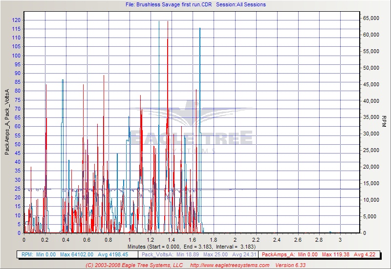

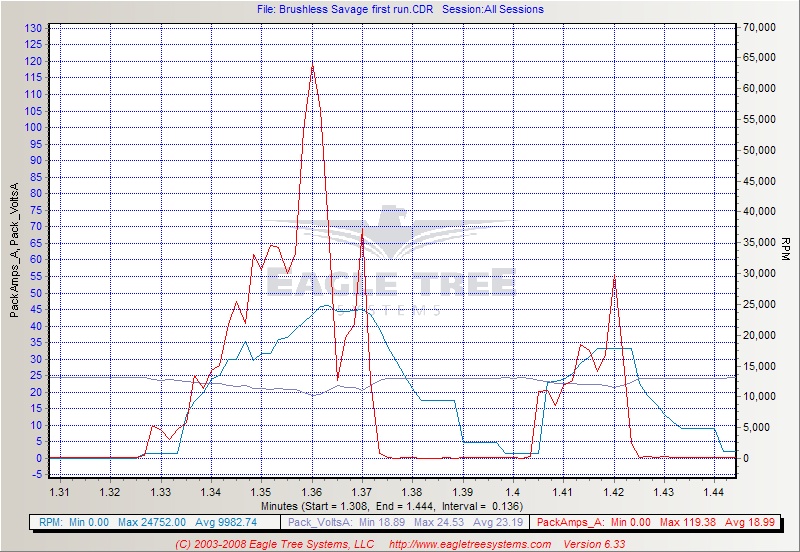

So I thought I would post my eagle tree data from my short run before my MMM died. The Eagle Tree CDR file is attached. The graphs below show most of it. The second picture shows the biggest amp spike. The most concerning thing is the voltage drop. The pack is a brand new 4900mah 6s 20c neu energy pack with a MMM and Feigao 11XL 1516kv motor. You can see in the graph where the MMM died. It is doing what others have described, fan twitches when it is switched on and off, and castle link can't connect to it. Also the 65000 rpm spikes are just errors from the brushless motor rpm sensor.

Seems that MMM have BEC issues on 6S running. More and more MMM users experince similar problem. Thx god that I didnt ordered MMM yet I descided to wait until comes out Motor/ESC combo
Btw my MM do spikes over 118A and its rated 100A and all seems is ok, its must be internal BEC issue on MMM

I really don't think that would have helped. The graph shows that I hadn't pushed the esc that hard going by the specs. The battery on the other hand was being pushed. I'm guessing a bad component failed but we will know in 2 or 3 weeks as my esc is on it's way back to the USA already.

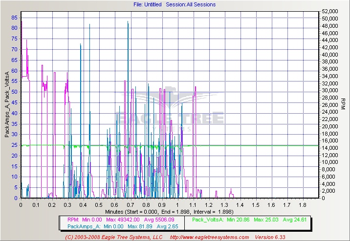

So I ran the Mamba Monster again in my savage after getting it back from Castle for repair. Guess where it is headed in the morning?
Anyway here is the pretty graph of the second run that lasted a hole minute and a half.
So am I the only lucky one to break this esc twice? Exactly the same symptoms as last time.
