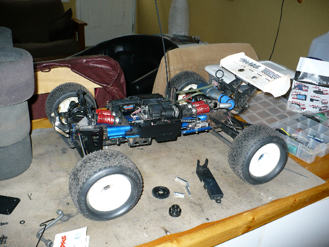

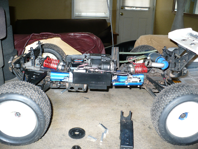

Here is a few pix just after I pulled the engine.
I tore the truck completely down, rebuilt the diffs and installed the teflon gtr shocks and everything else on a new 3racing chassis.

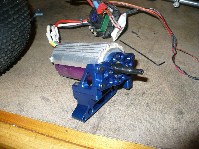

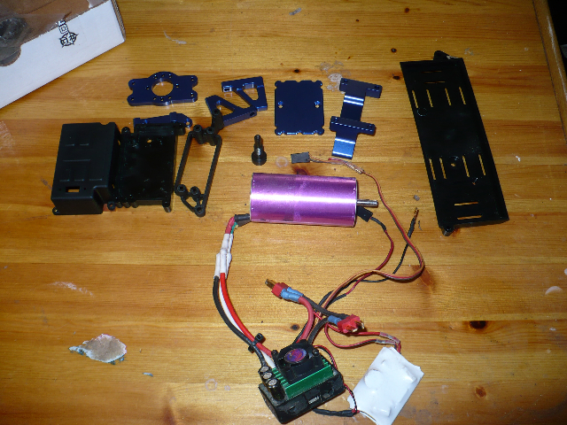

Here is all the goodies from Tekno and my esc/motor/BEC setup.

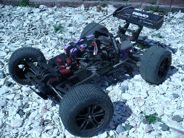

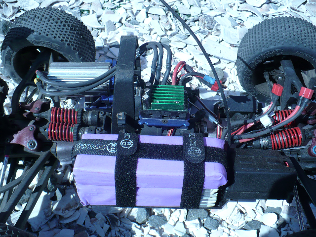

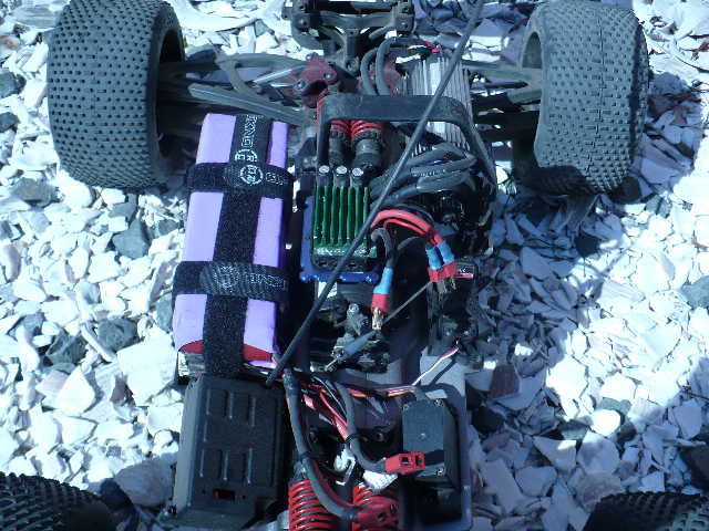

I skipped a few steps taking pix. Sorry I got carried away and forgot. But anyways here is the finished product more or less. Thanks to everyone on here who has given me input and helped me out to get this thing going.

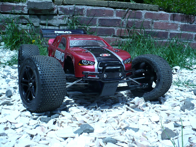

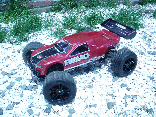

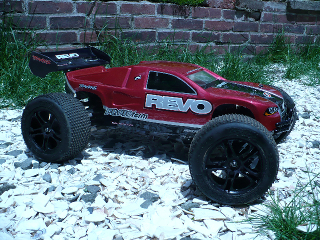

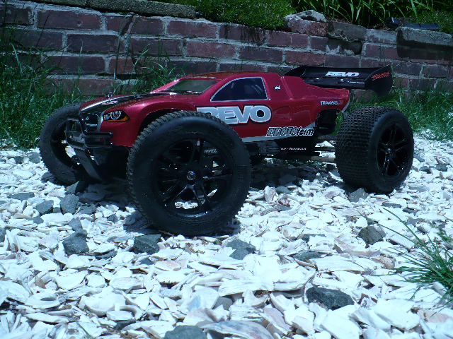

Got the body all painted and trimmed.
So the final setup is 10XL,MM, 5s 8000 true rc lipos.
The thing runs awesome. I had some clutch problems at first all is well now and I love it.
Just ordered some aluminum diff cups as I'm going through the stock ones pretty fast. Everything else seems to be holding up. I am planning on doing the tranny mod at some point. Sooner rather than later probably. Thanks again to everyone.
