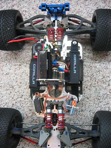

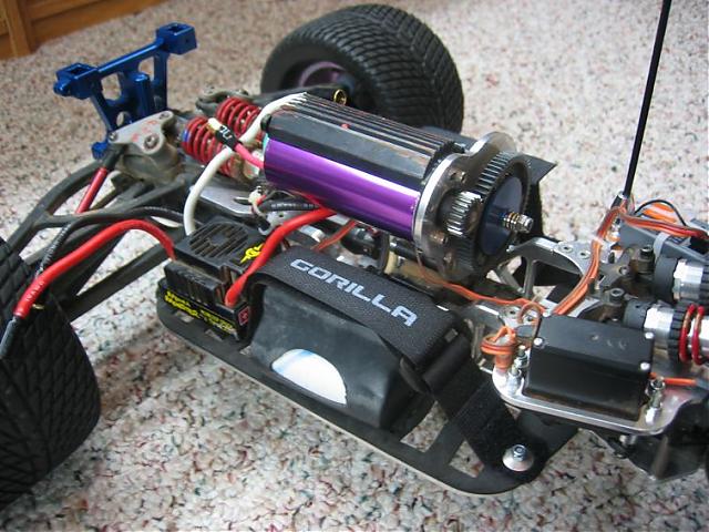

I put a triangle 3cell pack on my G3R chassis with no problem. It's the perfect width and the velcro straps hold 'em down fine. I run a 3cell pack on each side.
Here's a view before I got the velcro straps installed:

Gallagher
06.01.2008, 09:02 PM
Could you offer some photos? Thanks.

06.01.2008, 09:22 PM
Here some new photos I just took.

06.01.2008, 10:00 PM
I ran 5s on each side today... Cells are a little long but it worked ok.

06.02.2008, 01:11 AM
They look so huge and almost as high as the upper deck.
How do you fixed the 6s pack? With straps?
If with straps, it seems difficult due to the triangle shape.
I am planning to mount double 5s.

06.02.2008, 01:22 PM
Mounting triangle 6s packs will be done with the stock Gorillamaxx straps, or something abit more heavy duty if I feel the need. A strap or two running across the packs would be much more secure, just need to find something suitable... **to ebay he went, with a smile and cheer**.

06.02.2008, 09:01 PM
Neil, I went to the hardware store and bought some velcro and the plastic piece. I mad my own straps from these. Total cost: $6. I'll post a pic when I go home for lunch .
