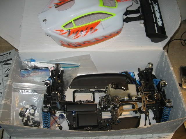

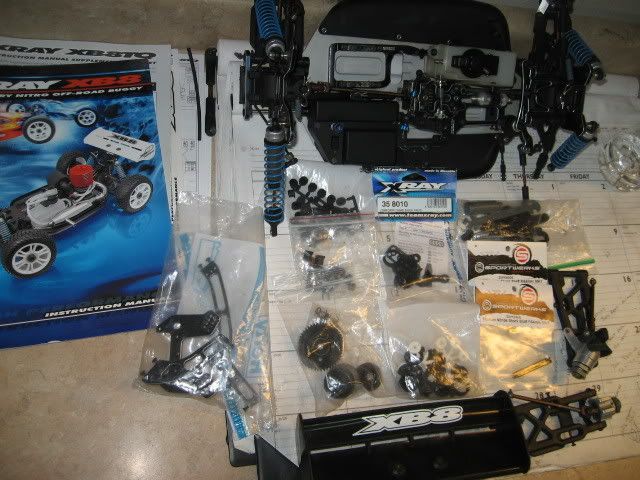

Look wait the mail man brought me today! I scored this rebuild / E conversion off E-Bay for a $250.00 (I think It’s worth it?!) We’ll see find out. I did come with loads of extra parts (small ones that will kill you if you don’t have them, kind of parts). It was purchased in 5/23/07 so it just over a year old this thing sold for $589.99, so I paid just over 40 cents on the dollar. I'm Feeling pretty good about that..
Look what I when out and bought myself today! (I'm feeling pretty good abut these too)..

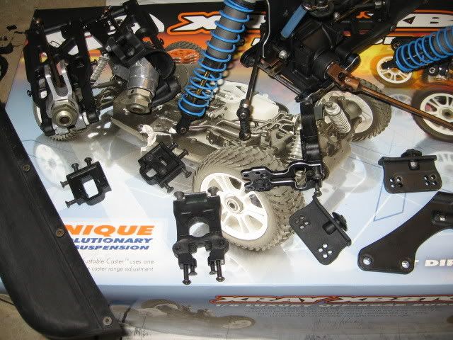

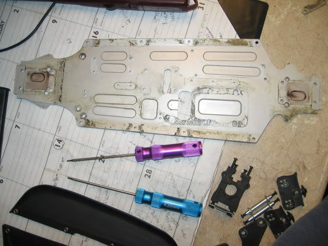

Dammm I hate the smell of Nitro so its a dissembling I go!..
Nothing!.. Hahahahaaa..

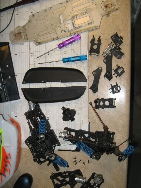

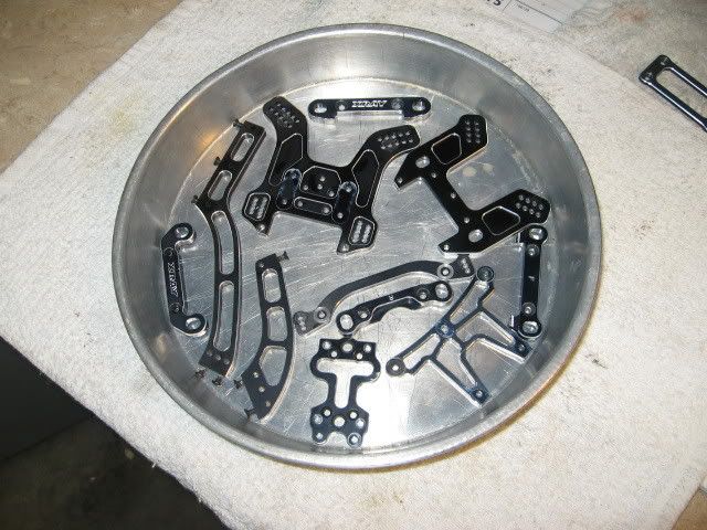

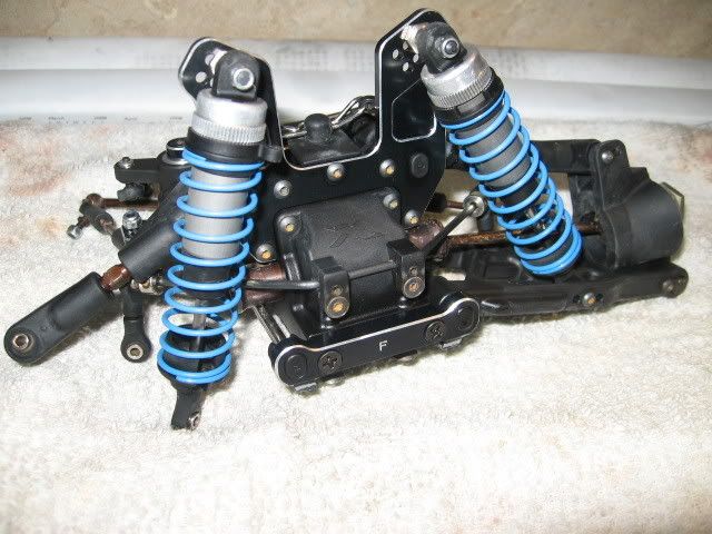

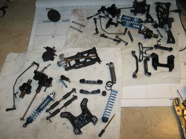

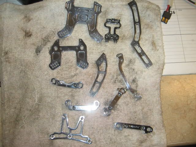

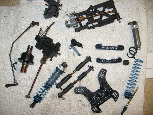

Ok, well after a soak in part cleaner (figuratively speaking) here is the parts look like at this point.. Not to bad at this point,
Next I need to strip it all the way down and change the oil in the front and rear diffs to 5,000 and use 30,000 in the centers. I already ordered the complete set of front and rear shocks off the 808 for this buggy (should have them next week).. I’ll also need to check the and probably replace the bearings as well..

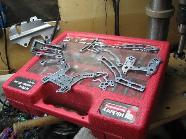

I'm also thinking of striping off all of this aftermarket XRay anodized parts to just shinny alum??. Something to try in the days to come. I’ve had great success with striping off Traxxas anodized off but I’ve never attempted any Huddy / Xray related! Have you??..
If you have any recommendation that I need to perform during it’s transformation from a Nitro burring, gas spewing, ozone depleting, garage smelling bad boy!. Into the environmentally friendly, local park driving, neighbor liking, track worthy (E) buggy.. Please feel free to shoot them my way!..

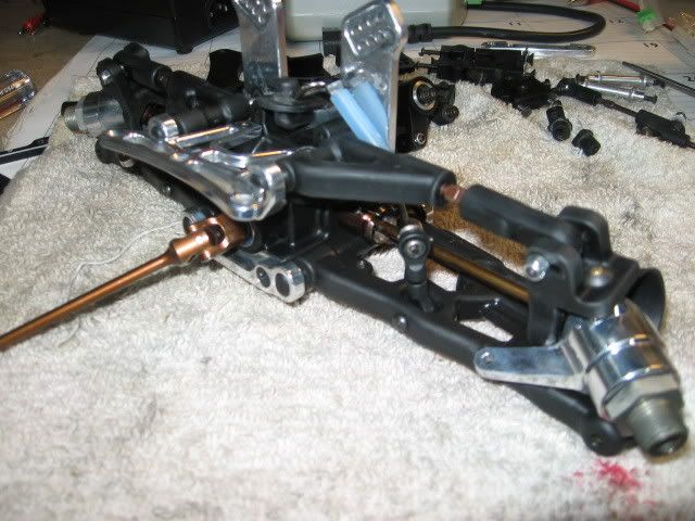

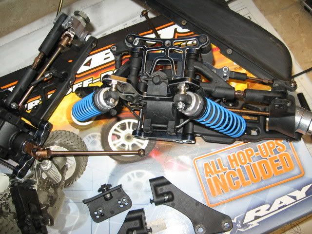

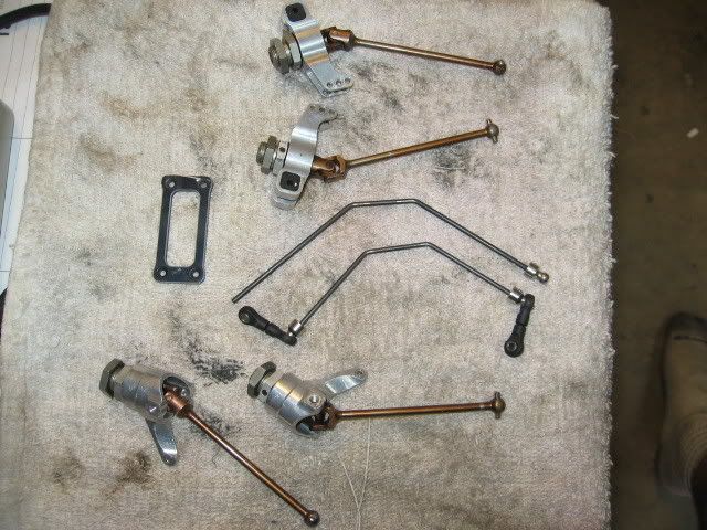

Good morning gentlemen,

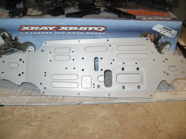

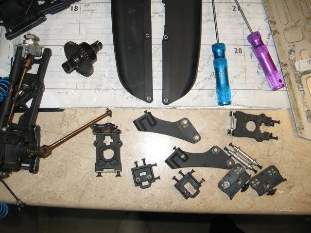

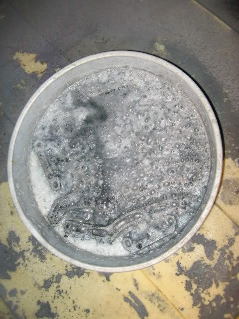

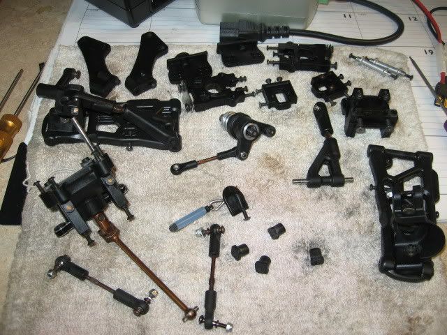

Here are some shots of forward progress that I was able to make this past week,

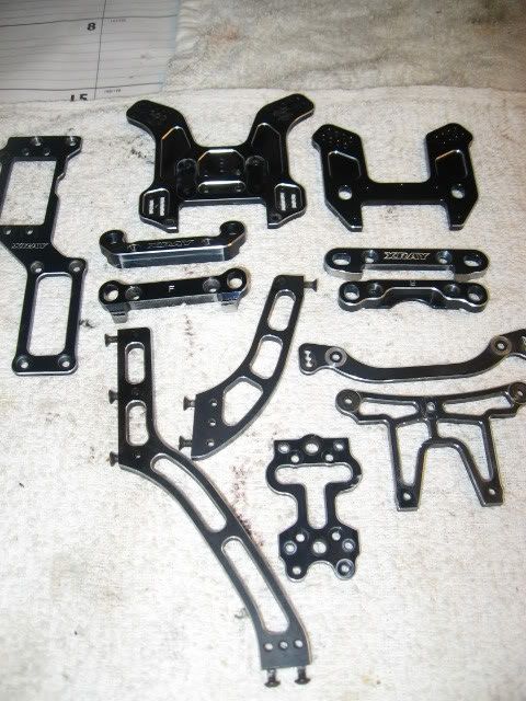

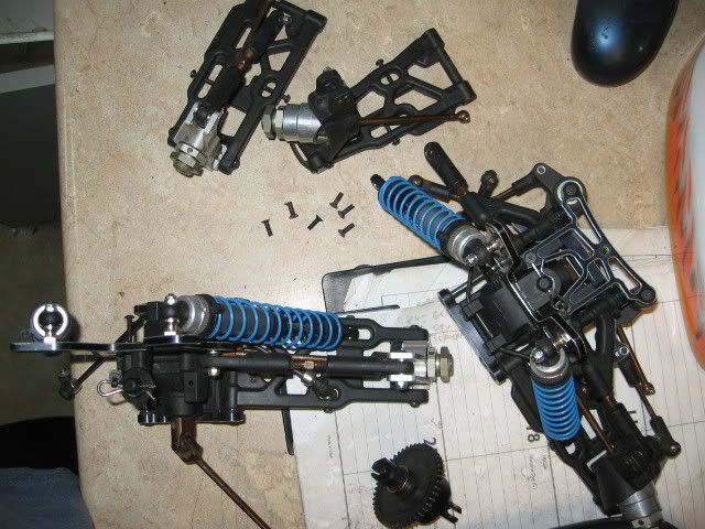

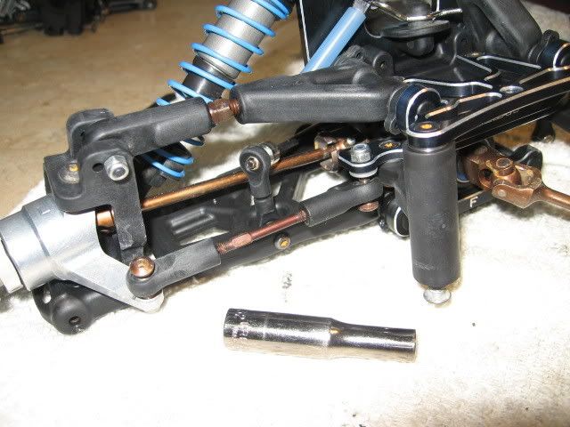

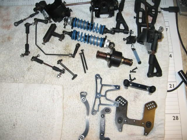

Completely disassembling the front and rear ends

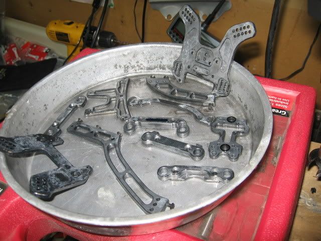

Starting the De-anodizeation process for all of the Almu parts.
TDC57
TDC57's Avatar
Posts: 1,728
06.09.2008, 03:15 AM

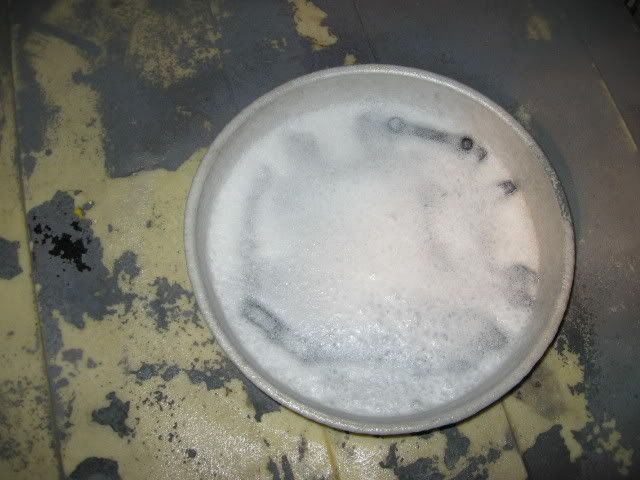

Halfway through the process,
Completed the transformation from a mild manner (blue and chrome) to polished
All of the anodized off and it been polished to high gloss finish.

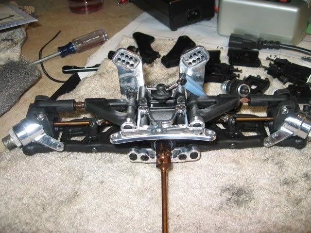

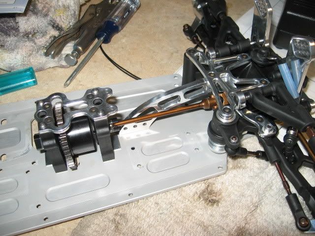

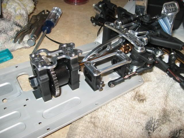

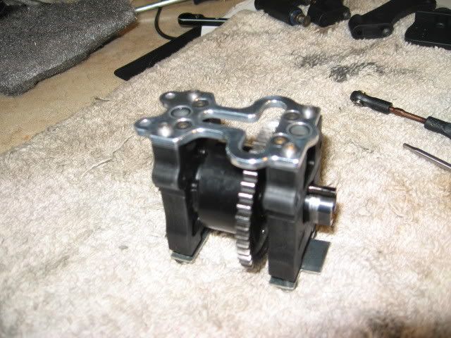

Front assemble going back together rather easy and without any issues so far.. Got to love the XRay..

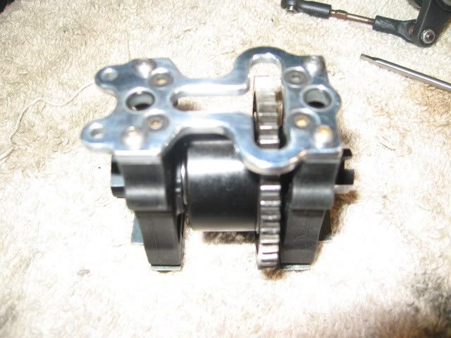

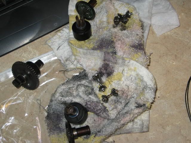

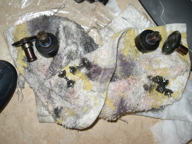

Time to work on the diffs I'm removing all of the old fluid and installing 7000 in the front, 30,000 in the center and 5,000 in the rear. Plus I’l be checking the bearings, seals and wear for possible required replacement.. Good news everything is good..

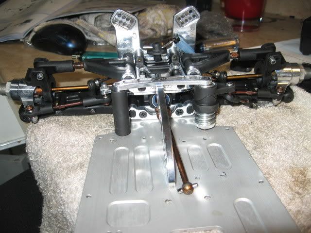

Time to install the front end and center drive

Yes I know I was extremely hesitant on removing the Ray colors at first but after about 5hrs of cleaning and polishing I think it was worth it, I’ve never seen a fully polished XRay so thought (what the hell)..
