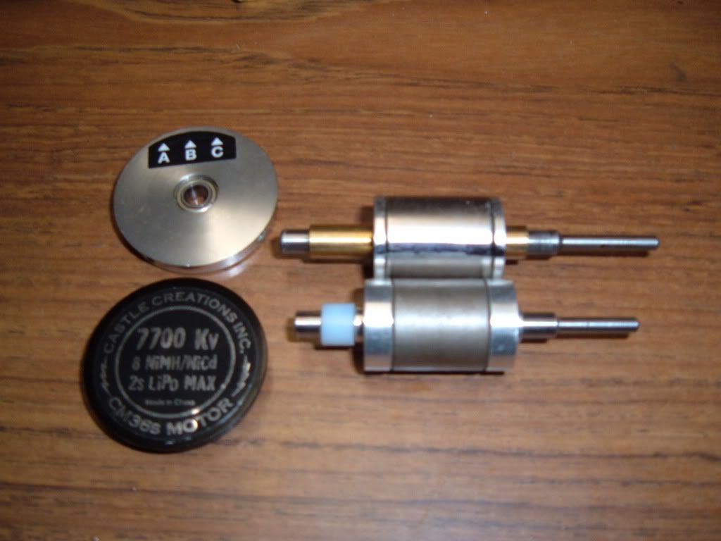

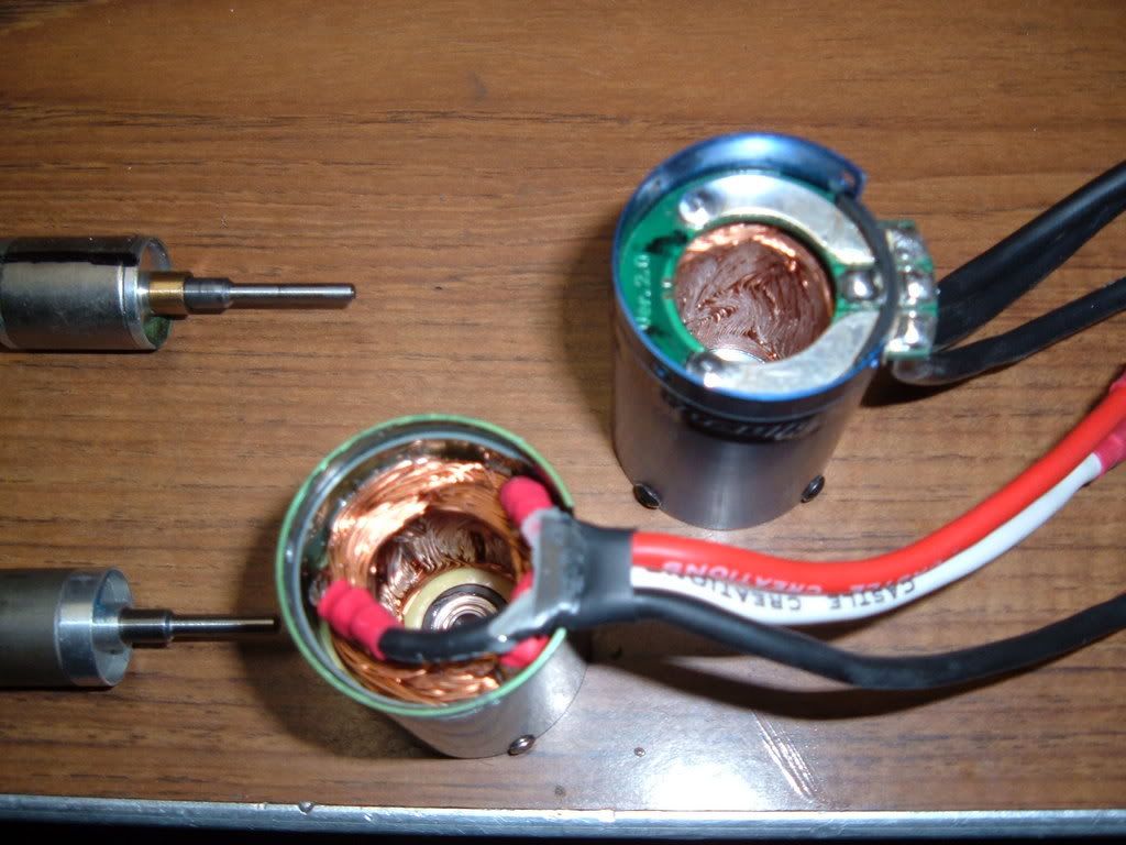

Actually the length difference of the can is for the internal solder plate.
The magnet is slightly longer on the velineon compared to the cc motors. I compared a velineon to a s can feigao, and the feigao ran cooler and could pull a higher gear, plus appeared to be more effecient. This may have something to do with the fact I ran the feigao with a mm and the vel was with the vel esc. The mm is a much superior esc. I am sure that the vel fares better than a cc motor due to its lower kv. The internals of both are virtually identical, while the s can feigao has a longer magnet and winding.
