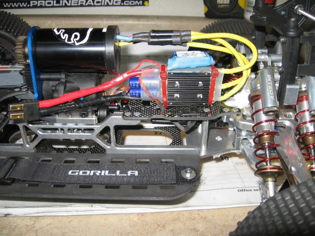

I have mine on edge like this:
Seems to be holding up well to bashing at least.

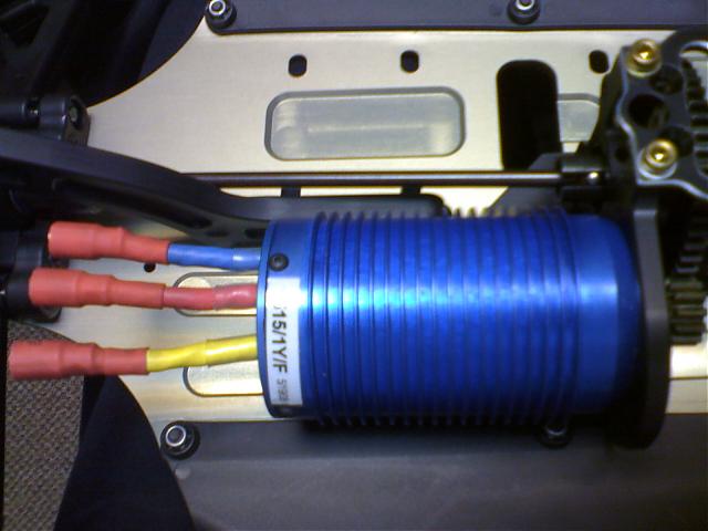

hi bdebde, could you tell me which wire to which for the mgm to a tekno bl motor cause i want to make sure nothing will happen to my first bl project! if you need to, pls take a look at the attach pics, thanks!
P.S. mine is a MGM 16018 3.23ver and with a tekno rc ed 1515 1y/f, btw pls start from the sticker side.

It won't matter which wire goes to which one on the motor. If it runs backwards, just swap 2 of the wires.
