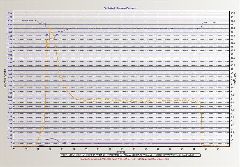

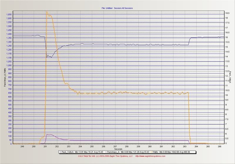

Because its loaded voltage what counts. Here's two graphs of a 4S and a 5S A123. Try to tell which one is which: (i've already given a bunch of hints )

07.07.2008, 11:51 PM
Good point, they do look about the same, dropping about 1V at a constant 50A draw. My guess is graph #2 is A123. based on not a lot. they really do look very similar.
