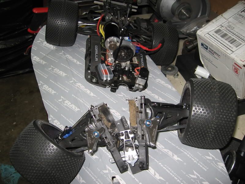

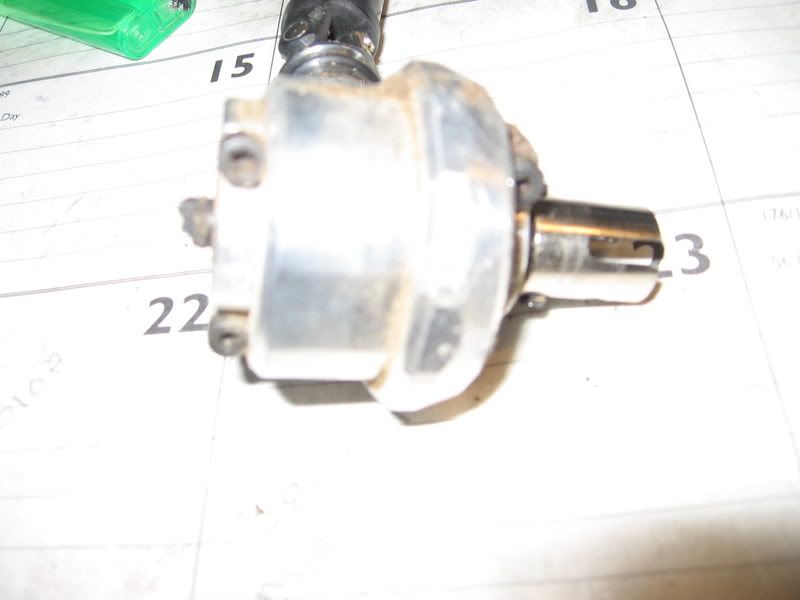

I found the week link on my GEVO, the akillies heal so to speak, it’s 8s..
Ever since I started to run this truck on 8s something always brakes (guaranteed) and for the last two outings it was same fricken part my (1/8 diff output shafts) last time it was the rear end, now it the front end and bent my axel. This thing just rips these output shafts in no time. That’s it putting it together again and then I wont drive it until Sunday @ our So-Cal bash, I’ll let someone else brake it for a change..

What diff output shafts are you using? What diff oil weight are you using? Are you running it in a place where there are some small stones that might get wedged between the arms and shafts. That was the only time I broke an axle shaft in one of my trucks.

Anyhow, I'm using the 1/8 scale one’s Mike sells so you know it not that, I’ve got 7k in the front and 5k in the rear, this combo works great on 4s, 6s, and I think 8s?? it really hard to tell the tires are spinning so fast and the car is just about uncontrollable at speeds or it my driving “lack of driving skills” I'm hoping the boys at the bash on Sunday will be able to confirm either or..
As for driving conditions it an off road truck I beat it everywhere I can find some dirt, hills, soccer fields, etc, it’s been at the local track now at least 4 times so nothing has changed their again 4 / 6s = no issues at all. I just think it’s the week link, everything has it and this in my GEVO’s week link = 8s.

Shaun, I'm done with my build ... for now . I had been beating the crap out of it and so far, I had been lucky except for a broken tranny output shaft.
It looks like a stress fracture on the diff output shaft's hole where it has the least amount of material which leads me to my hunch that either the axle was "forced" to rotate, very tight slipper, you had been mashing on the throttle or a combination of any of the three .
Anyway, using plastic drive shafts will help since it will twist the shaft first before it breaks the diff output shaft. The diff output shaft that comes with the hybrid revo diffs looks like a cut up version of the stock revo diff outputs. I made some of those by cutting the stock outputs (Tmaxx/emaxx).

Thanks for the information thou, I’m switching after this weekend bash with the boys and yes it was / is a stress crack at the weakest link. (hence my thought / my comment) I found my buggies week link.. 8s..
